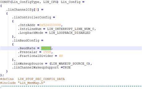

    I'm able to configure the lin baud rate as 9600 at my end with the latest plugins. May I know what is the issue that you are facing?

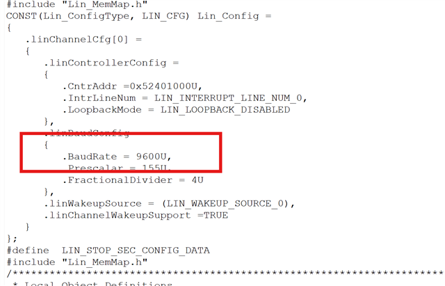

  • Hello Nikhil,
    I have configured the LIN Baudrate as 9600 and tested on PLIN, but I'm not able to see any frames. I've Observed that even if I configured 9600 as baudrate but PLIN is detecting the value as 19200.
    Please check the reference video which is shared below
    Can you please check and provide your feedback
    Mohasin
  • Hi Mohasin,
    You need to run auto-calculate button in the Tresos GUI to update the Prescalar and Divider values. Since these values are used to set the baud rate, running auto-calc is essential.
