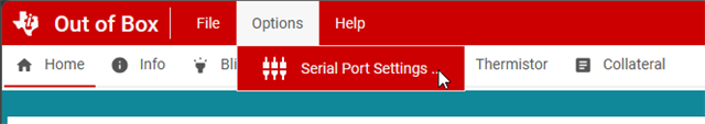

Part Number: LP-MSPM0L1306
See connection on cloud window, but GUI triggers are not responding per instructions
Hi Noble,
Can you verify that you have successfully loaded the example to the device:
Upon a successful load, ensure that you have configured the baud rate to be 115200, as specified in the README:
Also ensure that the correct COM port is selected. In Device Manager, look for the COM port that contains UART in its name:
Verify that the jumpers on J16 and J17 and configured such that the UART is connected to the XDS rather than the BoosterPack (BP) headers.
Owen
