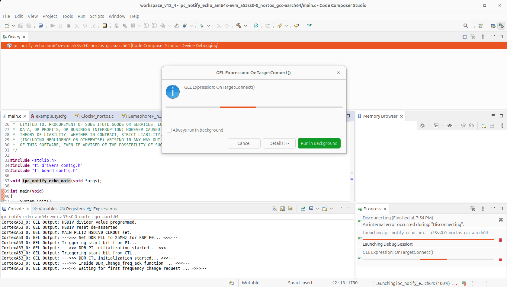

Part Number: AM6411
/ipc_notify_echo_am64x-evm_a53ss0-0_nortos_gcc-aarch64/targetConfigs/AM64x.ccxml
Code Composer Studio
Version: 12.4.0.00007

both cores running, but I can't seen any output in the console, no sign that the two core communicate

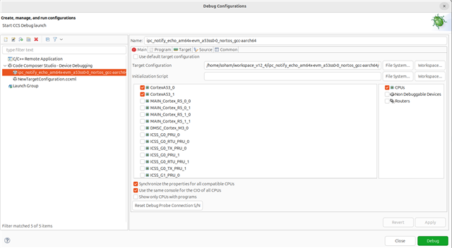

software-dl.ti.com/.../EXAMPLES_DRIVERS_IPC_NOTIFY_ECHO.html
I solved the issue by checking target configs to am64 instead of AM64x_GP_EVM
