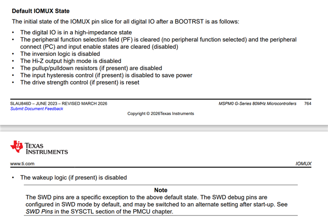

I would like to know the state of each pin from power-on to reset and then to the point where the pins are programmed.
I am particularly interested in PA2.
Where in the datasheet should I look for this information?
I'd like to know information such as whether it's a Hiz connection, whether it leads to an internal pull-down resistor, or whether it leads to an internal pull-up resistor.
