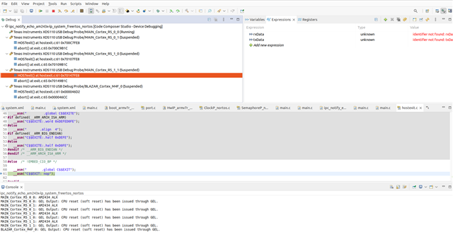

    3. Loaded the generated application onto the LP-AM2434 LaunchPad using CCS.
    However, after loading and running the application, execution appears to remain in the vApplicationIdleHook(void) function and does not proceed as expected. As a result, I am unable to observe the IPC notification exchange described in the example documentation.

    You will need to run application on all other cores as well. I can only see you are running R5F0-0 core application, rest all cores are still halted at main() function call.
    Please run all the cores and update the results.

    I followed your suggestion and manually ran the application on all cores.
    After running all cores, the application does not appear to execute as expected. Instead, execution eventually halts at HOSTexit(). I have attached screenshots showing this behavior for reference.

    From the above it looks like you code has been successfully executed. Can you try opening all the UART COM ports and check whether the logs are coming or not?
    Tushar
  • Hi Tushar,
    Thank you for the suggestion.
    I opened all available UART COM ports and was able to observe the expected output. The logs indicate that the IPC Notify Echo example executes successfully on all cores and completes with the message "All tests have passed!!". The output is shown below for reference:
