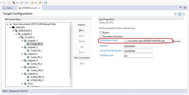

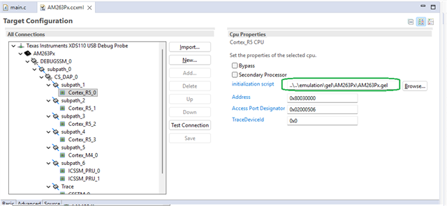

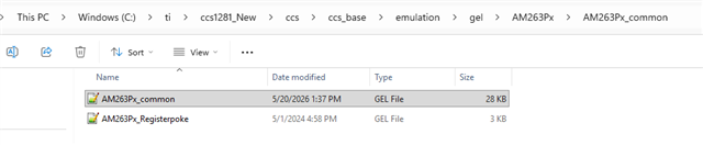

    1. If you are testing without bootloader and using dev boot mode, then in old versions of CCS i found Gel path is wrong:
    The path should be:
    If this gel path is not correct then the initializations that i mentioned in step-1 will not happen in dev boot mode.
    3. And also, for AM263Px devices make sure proper value that is 0x3F in initializations:
    Because we found it is just 0xF for some old versions of devices, that means only 4 banks are initialized instead of all 6 banks in OCSRAM.
