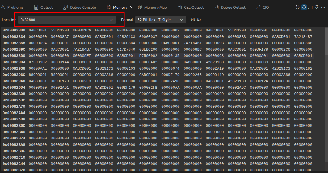

  • The ROM logs the boot time log in the TCMB memory region. The address were it is stored is 0x82800.
    The TCMB logs can be parsed into meaningful messages. It will tell us regarding where the boot has failed.

    3. Now launch the TG and connect to core 0-0.

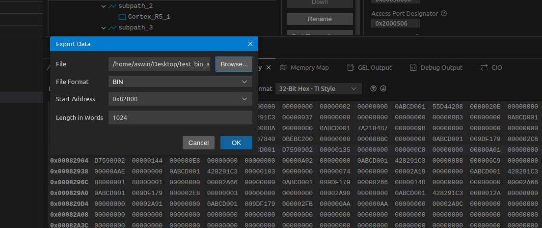

    4. After connecting enter this address is memory browser.
    Export it as bin file.
    Start Address: 0x82800
    Length in Words: 1024
    5. Once bin file as been saved execute this command. The .exe and .csv has been attached.
    parse_log_win.zip
    Command to be executed:
    ./parse_log_win.exe test_bin_am263pcc.bin log_dictionary_r5_am263px_gen.csv > test_bin_am263pcc_output.txt
