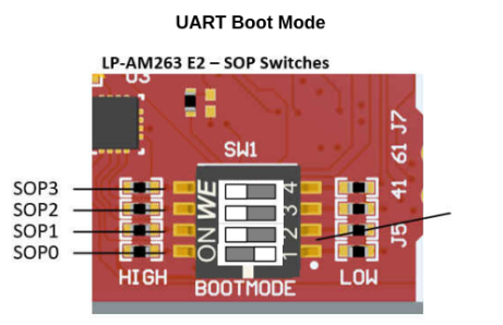

I was following the quick-start guide in the attached pdf. I got to the part where I am supposed to read some "CCC" from the serial terminal but I was unable to read anything from the Sitara card.

    Can you please share what boot-mode you are using? IF it is the control-card, UART Bootmode is:
    IF it is the launchpad, UART Bootmode is:

  • I am using the control card. Not the launchpad.
