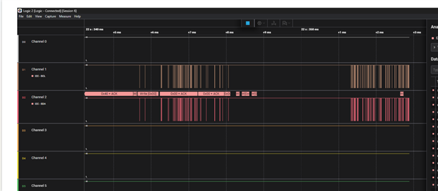

  • Hi Tushar
    we are facing some issue with EEPROM IC where in 5 boards out of 50 boards are showing this error.
    below is the waveform of SDA and SCL signals of working board
    below is the waveform of SDA and SCL signals of not working board,you can see the bus is busy and for 5ms and in the firmware is there any fixed wait period?
    You must allow 5ms from the last Write protocol I2C Stop Condition before sending any new I2C command right?.
    If you only allow 3.5ms before the ISR times out and throws the error, you will be falsely failing perfectly good AT24CM01 devices.

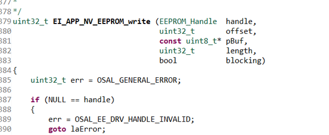

  • Hi Tushar
    We are using  ind_comms_sdk_am243x_09_02_00_24 , and in C:\ti\ind_comms_sdk_am243x_09_02_00_24\examples\industrial_comms\ethernetip_adapter_demo_original\board\am243x-lp\freertos\drivers\eeprom\CUST_eeprom, I dont see any API being called but in appNvEeprom I  see as below , which does not have any wait period.
  • Hi Yashaswini,
    I can not see the above mentioned API in the specified file. Also, you can call the Clock_usleep function with 5ms timeout for EEPROM write to complete.
