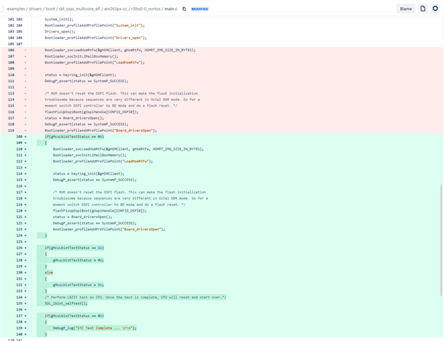

  • Hi ,
    Thanks for letting us know about this issue, I checked the diff between SBLs in both .01 and .06 release and see what might be breaking the bootloader. While we fix this internally, can you please continue using the 26_00_00_01 SBLs (so that you are not blocked). The change pasted below seems to be breaking the flow. Let me take this up internally with the team and investigate further.
