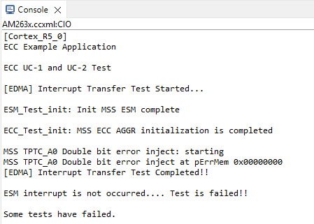

I've referred example code for sdl_ecc_mss_tptc_am263px to understand ECC error injection in tptc memory. The example code itself is failing

I can be able to reproduce this issue at my end, i am checking this with development team to understand the root cause. I will get back to you on this as soon as possible.

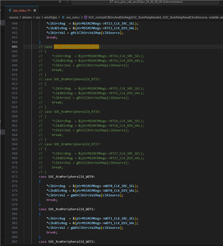

In mean time i would suggest you the changes, could you please do those changes and let me know the test results in both Dev boot mode and OSPI boot mode?
1. In soc_rcm.c comment out the cases from SOC_RcmPeripheralId_RTI4 to SOC_RcmPeripheralId_RTI7

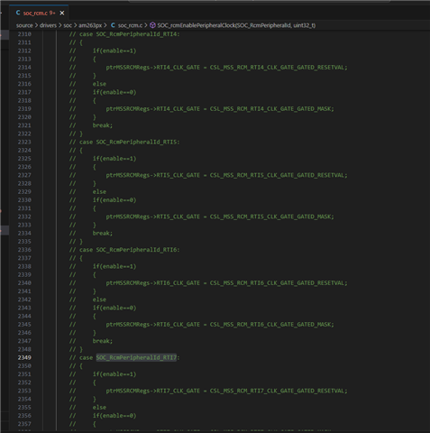

2. In the same file comment out these lines as well:

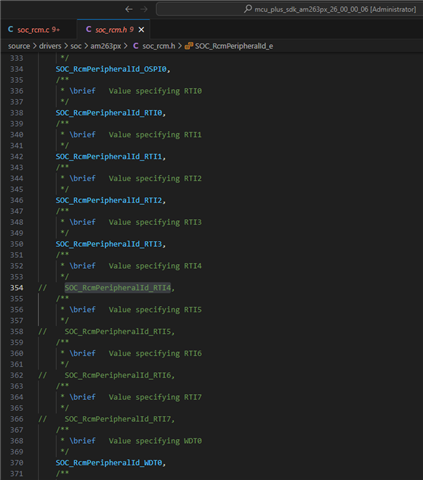

3. In soc_rcm.h comment out these lines as well

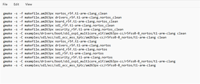

After doing above three modifications now do below build steps and perform testing in both OSPI and dev boot mode testing and see the results:
