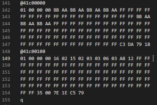

Q1:Even when using a .txt file that includes the CRC at address 0x41C00000 as shown in the attachment, the GUI displays "Mass Erase" instead of "Factory Reset". Is this expected behavior, or is there an issue?

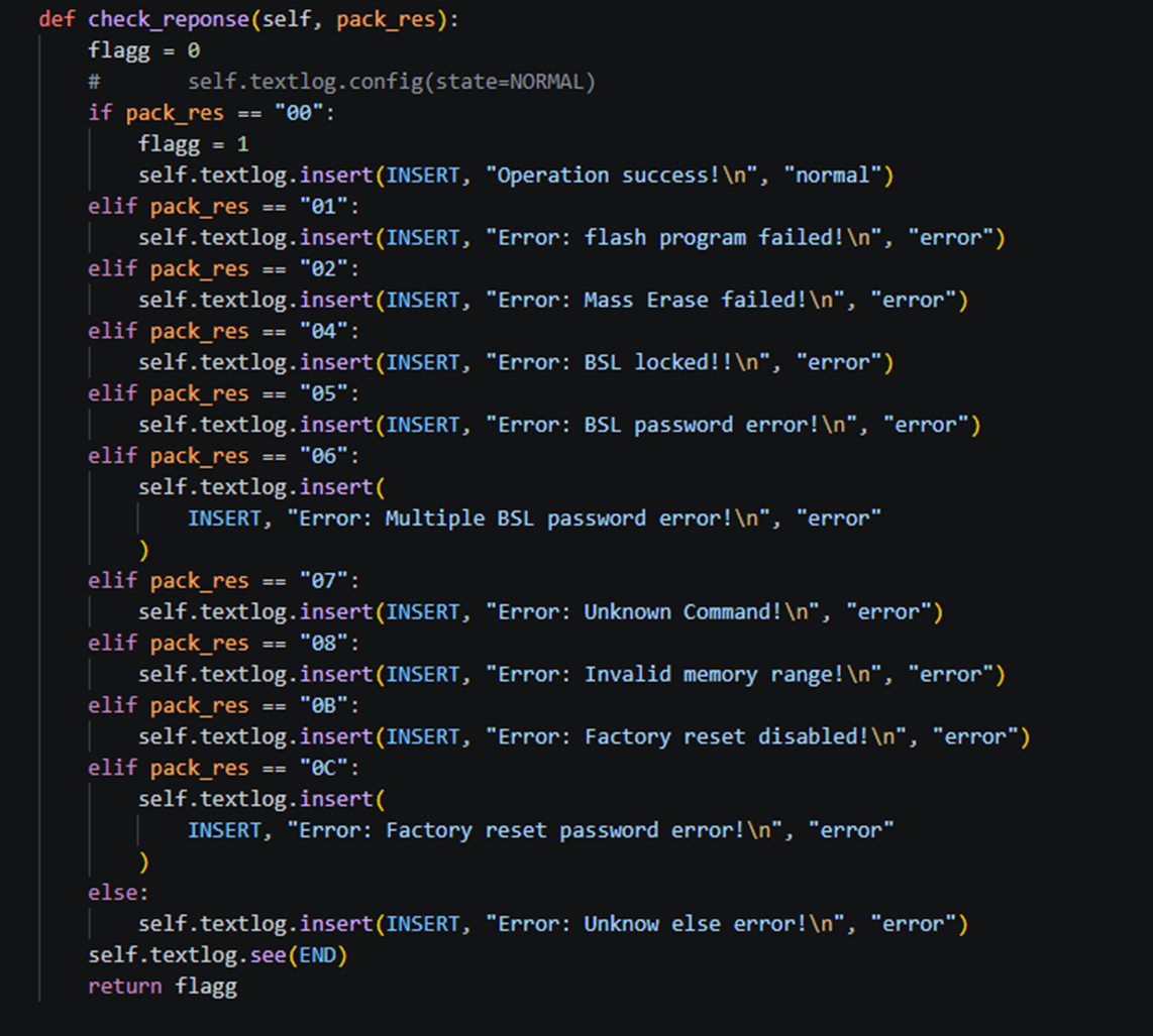

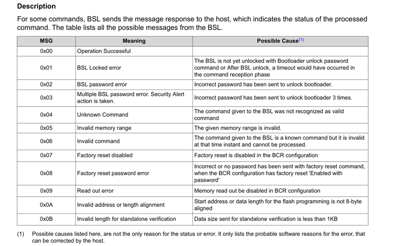

Q2:
The MSG contents described in 4.4.1 Bootloader Core Message of slau887a.pdf do not match the implementation of check_reponse() in MSPM0_BSL_GUI.py.
How should this discrepancy be interpreted?

  • Hello O.H,
    1. This GUI won't operate NONMAIN, it just download code into MAIN Flash. "Mass erase" is normal, after mass erase, it will program code into Flash. And it won't operate factory reset.
    2. Thanks for your feedback, we will fix it in next version.
    3. Please just use the GUI shared in the E2E, don't need to generate by yourself. [FAQ] MSPM0L1306: BSL_GUI_EXE update - Arm-based microcontrollers forum - Arm-based microcontrollers - TI E2E support forums

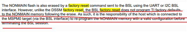

  • Hello Janz Bai,
    Thank you for your reply.
    Sorry for not providing the background information earlier.
    The customer is evaluating the I2C BSL on a prototype board. Since the GUI only supports UART, they are developing a custom tool based on the GUI source code. In order to change the BSL I2C slave address, writing to the NONMAIN memory is required.
    Now we understand that the GUI does not support Factory Reset. We are executing the process with the following flow based on the source code, however, for some reason the process fails after the Factory Reset. The CRC and BCR become invalid, and it is no longer possible to perform a DSSM Factory Reset via CCS.
    Q4: Are there any mistakes or concerns in this procedure?
    1. Software Invoke: Reused invokeBSLAsm() from bsl_software_invoke_app_demo_i2c
    2. CMD Connection
    3. Status Check
    4. CMD Get Device Info
    5. CMD Unlock Bootloader
    6. CMD Factory Reset: Used when modifying NONMAIN. Since MAIN is also erased, it is necessary to back up calibration data in advance
    7. CMD Program Data
    8. CMD Start Application
    O.H
  • Also
    Q2-2: Which is correct, "slau887a.pdf" or the GUI? Which one do you plan to fix?
    O.H

  • Hello O.H,
    About the Q4:
    • If they need to do BSL through I2C interface, why they need to modify the BSL I2C target address through BSL? BSL I2C target address can be configured in NONMAIN through Sysconfig directly. They can configure the NONMAIN firstly and then download it into the device.
    • I have checked the BSL process you mentioned, I think it is ok. It is the normal process of BSL. But please notice below. Customer need to program the whole NONAIN region after the factory reset command.
    About Q2-2:
    The user guide is right, we will fix the GUI.
