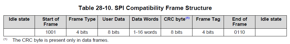

  • . Reference example or SysConfig guide for using FSI as SPI
    • We plan to use FSI0 (specifically pins GPIO29 to GPIO32) for SPI communication.
    • Question: Could you provide or recommend a reference SysConfig profile or example project that demonstrates how to configure and use FSI as an SPI interface?
    While the FSI SPI compatibility mode is able to match the physical interface of a regular SPI, it is not equivalent to a regular SPI module and has some specific limitations.
    • FSI-SPI can only transmit and receive the frame format below, therefore it can only interface with SPI devices that can receive/transmit this frame structure. The Data words section consists of 1 to 16 configurable 16-bit words.
    Please confirm that the SPI device on other end is compatible with this format

      Before recommending a configuration path, there is an important compatibility point to verify. FSI in SPI compatibility mode uses a fixed frame structure that is not equivalent to standard SPI. Every transaction includes a mandatory frame tag word, one to sixteen 16-bit data words, and a CRC word. The device on the receiving end must be capable of handling this specific frame structure.
      Could you confirm what the target device is that you intend to connect via FSI0 on GPIO29 through GPIO32? If it is a standard SPI peripheral such as a sensor, ADC, or DAC that expects conventional SPI framing, FSI SPI compatibility mode will not function as a direct replacement, and using one of the available MCSPI instances on the AM2612A would be the more appropriate solution. Once you confirm the target device, we can advise on the correct configuration path and point you to the relevant SysConfig setup.

      3. FSI as SPI Reference Configuration
      The target device connecting to FSI0 on the AM2612 MCU is the SPI3 instance of an AM13E23019 MCU.
      This interface will be used to exchange Safety data between the two MCUs.
