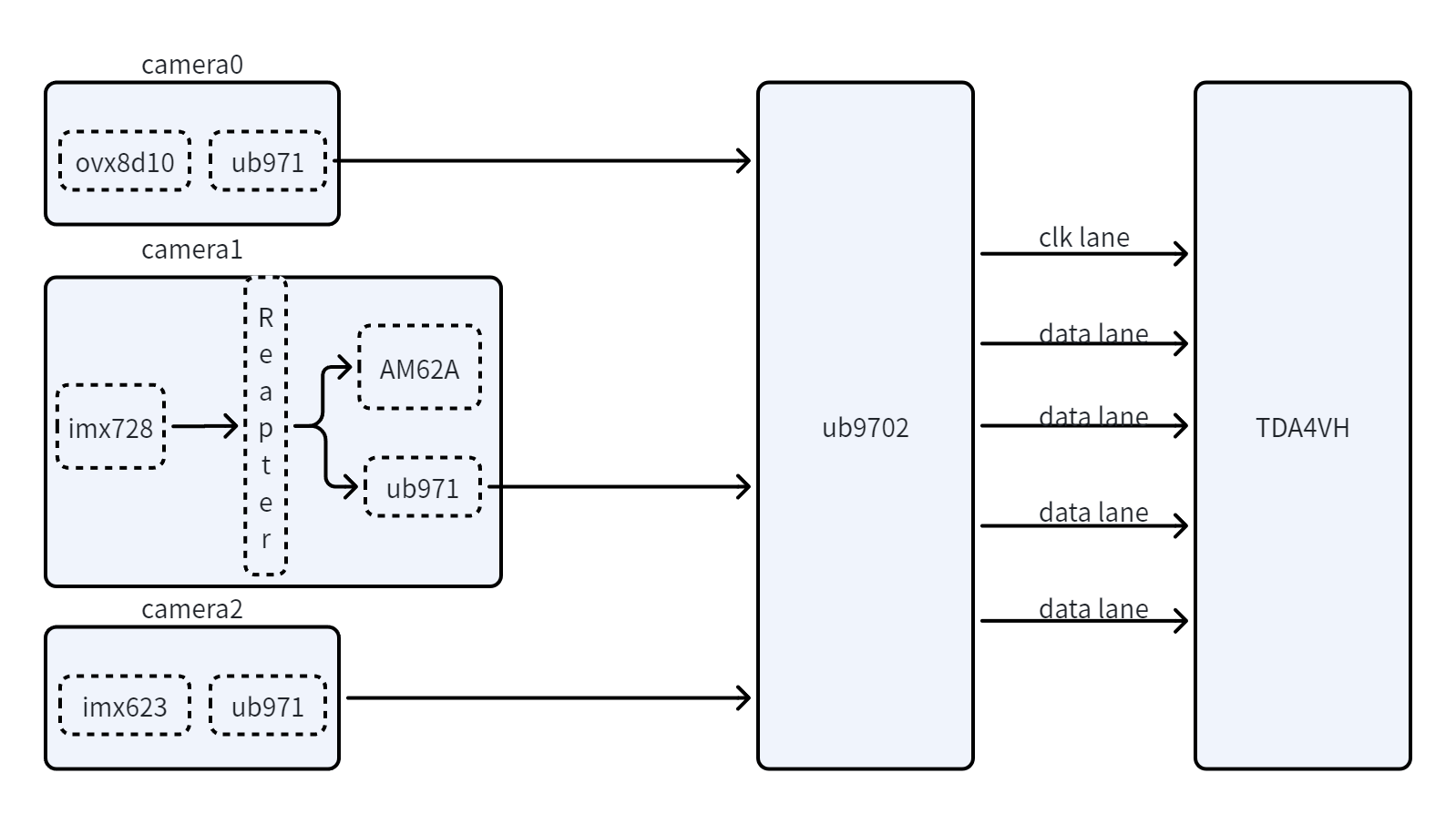

The SOC is connected to three cameras: 8M (x8d10), 8M (imx728), and 2.5M (imx623).
The imx728 is connected to AM62A and UB971 respectively through the MIPI repeater.
After the TDA4VH MCU2_0 is powered on, start configuring the serializer and deserializer, and keep the deserializer's csi output disabled.Then start the "vision_app" to create an "openvx capture node" for receiving data.
ISSUE:
Before configuring the serializer and deserializer in MCU2_0, if AM62A has already transmitted data to TDA4VH through the MIPI repeater, the TDA4VH capture node can normally receive the data.
If when configuring the serializer and deserializer on MCU2_0, AM62A fails to send data to TDA4VH via the MIPI repeater(for example, if AM62A power late), the TDA4VH capture node will not receive all channel data.

  • Hi Brijesh
    Three nodes (TIVX_TARGET_CAPTURE1, TIVX_TARGET_CAPTURE2, TIVX_TARGET_CAPTURE3) are used to receive data from the three channels respectively.
    If the physical connection to the AM62A is disconnected and TDA4 is started, data from the other two channels can be received normally.
    When TDA4 is started while the AM62A is connected, because the AM62A transmits data relatively slowly, all three capture nodes will fail to receive data.
    Can you analyze the cause of the problem from the register information?
