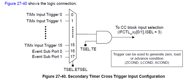

Theoretically it would work to use Timer G7 as the master and Timer A as slaves so that I can have TIMA0 and TIMA1 as two slave PWMs.
From the example in the post, the master is switched from TIMA1 to TIMG7, it doesn't trigger the slave PAM even all the setting are checked correct as below:
For master:
for slave:
And if switching to use TIMA0 as the master, it also doesn't trigger the slave PWM at TIMA1 and TIMG7.
What might be missing in the configuration?
Thanks!
Crane
