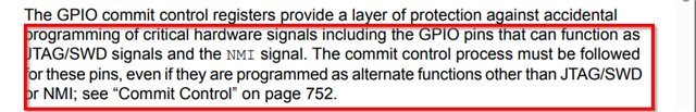

    1. It is only able to determine if the pin is high. However you should be able to use this for rising edge detection.
    2.you will also need to use the commit control registers to lock the NMI pin
    3. The NMI would just generate a different type of interrupt instead nothing else needs to be configured.
    4. That should be good
    5. It would be a strong pull down resistor (20.5 ohms) if you're using the internal pull-down resistor.

  • Hi Sarath,
    Sorry for the delays. The best way to go about this would be to configure the NMI handler to remove the pin configuration after the NMI has been triggered. to do this you can read the NMIC register NMI handler.
    Try this code in the NMI handler:
     uint32_t nmiSource = HWREG(SYSCTL_NMIC);
        if (nmiSource & SYSCTL_NMIC_EXTERNAL)
            // 2. Unlock the GPIO commit control for PD7
            HWREG(GPIO_PORTD_BASE + GPIO_O_LOCK) = GPIO_LOCK_KEY;  // 0x4C4F434B
            HWREG(GPIO_PORTD_BASE + GPIO_O_CR)  |= 0x80;           // Enable commit for bit 7
            // 3. Disable the NMI alternate function on PD7 (revert to GPIO)
            HWREG(GPIO_PORTD_BASE + GPIO_O_AFSEL) &= ~0x80;
            // 4. Clear the PCTL field for PD7 (set mux to 0 = GPIO)
            HWREG(GPIO_PORTD_BASE + GPIO_O_PCTL) &= ~0xF0000000;
            // 5. Optionally disable digital enable to fully tri-state the pin
            // HWREG(GPIO_PORTD_BASE + GPIO_O_DEN) &= ~0x80;
            // 6. Re-lock the commit control
            HWREG(GPIO_PORTD_BASE + GPIO_O_LOCK) = 0;
            // 7. Clear the NMI source
            SysCtlNMIClear(SYSCTL_NMI_EXTERNAL);
            // --- Handle your edge event here ---
