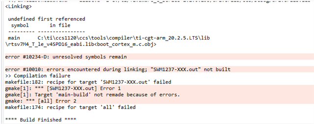

  • Sorry Xiaodong, I would like to re-open this. In CCS I switched to correct part TM4C1299NCZAD as you suggested but am getting compilation errors. I wanted to paste some screenshots here but the company is blocking them. Do you know an alternate way I can share pictures? In the meantime I will try to get this resolved on my end with IT department.

  • Hi Xiaodong,
    I am getting compilation errors. I copy links to some pictures. Please let me know if you are able to open them.
    Felix
  • Yes. I can open this link and see the images following
  • Hi Xiaodong, I was able to fix the compilation errors.
