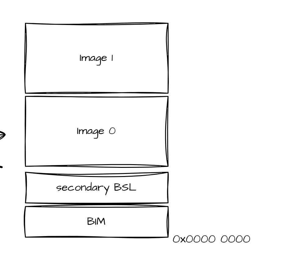

I am currently integrating BIM and a secondary BSL, and I am facing an issue after combining all components.
Memory Layout
My memory allocation is shown below.
Software Flow
  1. Perform DFU using the BIM demo to manage the boot process.
  2. BIM starts correctly after power-up.
  3. BIM successfully selects and launches the latest application image.
  4. The application runs normally.
  5. The application then invokes the secondary BSL.

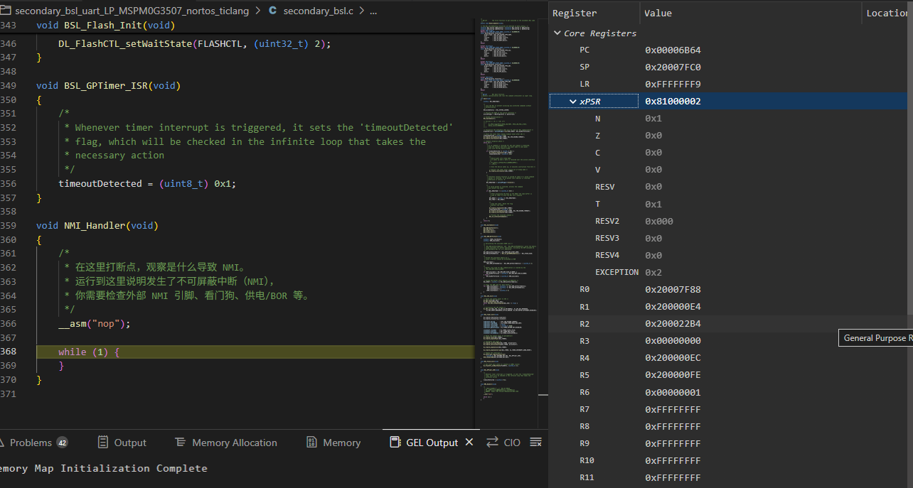

To debug, I loaded the secondary BSL symbols into the debugger without a dedicated project. The debugger stops in:
  • Default_Handler
  • NMI_Handler
This suggests that an exception or interrupt was occurring after the jump to the secondary BSL.

  • Hi Zq,
    Since the debugger is stopping in both Default_Handler and NMI_Handler, it would help to know which one is
    actually, being caught - they point to different root causes.
    For NMI_Handler: the SYSCTL IIDX register will tell you which NMI source fired. The two maps below show the
    possible sources - check SYSCTL IIDX against these to identify which event triggered it.
    For Default_Handler: what peripherals do you have enabled in your secondary BSL, and do you have handlers for
    each of them? If the application left any peripherals with pending interrupts before jumping to the BSL and the
    BSL's vector table doesn't cover those, execution will land in Default_Handler. Walk through each peripheral's
    IIDX register to find the unserviced interrupt.
    Brian
  • Hi Brian,
    Thanks for your useful tips.
    The issue is an NMI SRAM ECC error; I’ve attached a screenshot below.
    However, I already clear SRAM before entering BSL. During debugging, I checked 0x20200000 and 20300000 ist cleared. Here is my BSL invoke code

  • Hi Zq,
    The BSL invoke code is correct. One thing that was noticed in our secondary BSL examples, was the SRAM start address is 0x20000000, but should be 0x20200000:
    Can you check the linkers of all your projects to make sure SRAM starts at 0x20200000?
    Brian
  • Hi Brian,
    Thank you for your reply.
    I found the issue yesterday as well. I thought I had copied the linker file incorrectly from the demo. Everything is working now. Grinning
    Cheers,
    Zq
