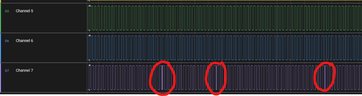

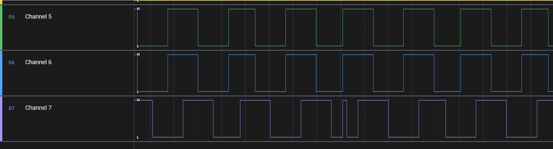

I tested the phase shift in PWM, using TIMG(standard) to TIMA(shift), and I can see the glitch on phase shifted PWM signal.
  • Channel 5: Main_Cross trigger, TIMG (Standard)
  • Channel 6: Secondary_Cross trigger, TIMG (Phase shifted X)
  • Channel 7: Secondary_Cross trigger, TIMA (Phase shifted O)
On Channel 6 without phase shift, this signal is clear, but there's some glitchs on Channel 7 very randomly, which is shifted the phase.
But when I tested with TIMA to TIMA, it doesn't happen the glitch. (but there's only one TIMA in M0L1227, so I need to use TIMG for standard)
Do you know the reason why the glitch happend when I use the TIMG as standard, and do you have any idea to fix this issue?
Many thanks,
Yesol

  • Hi Yesol,
    I ran your code on an LP-MSPM0L2228 and I was unable to observe any of the glitches using my Saleae running at 100MS/s. What is the pulse-width of the glitches? Are you grounding your Saleae? I may need to use a fast sampling Saleae depending on the pulse-width.
    Owen
  • Hi Owen,
    The pulse-width of glitches are all 160ns, and this glitchy signal appears randomly and continuously on phase shifted PWM signal when the Main_Cross trigger is TIMG.
    I grounded Saleae to the GND on the same EVM.
    I've also tested with three other M0L2228 EVMs, but I can see the same glitch on phase shifted PWM signal.
    - PWM Period Count: 80
    - Caculated PWM Frequency (Hz): 400000
    - Timer Clock: BUSCLK, 32000000 (Divided by 1, Prescale 1)
    Many thanks,
    Yesol
