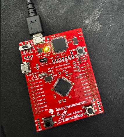

So sorry for not responding, but I have a TM4C123GXL that I cannot get to work on my laptop at all, can you help me out please?
It's not showing up on the device manager or on the LM Flash Programmer or the CCS, so I dont know what to do to get it to show up.
My TM4C123GXL when connected via DEBUG mode lights up the PWR LED but does not show on the laptop, so I cannot flash it or unlock it
I attempted to press and hold RESET while connecting to PC, but still nothing is happening, and I tried to troubleshoot it, but I cannot
I am using Tiva C Series LaunchPad Evaluation Kit EK-TM4C123GXL

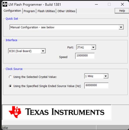

It was working before, but when I tried to do a firmware update using LMFLASHPROGRAMMER it instantly stopped responding and I cannot get it to respond any more. but the PWR LED is still ON, so it is getting power, but no longer connecting via USB.

  • Hi Josel,
    I believe there's an issue with the XDS110 on the board. If you have another Launchpad you can flywire the XDS110 launchpads together.

  • Hi Erik,
    Do you mean this chip?
    Unfortunately, I don't have any other LaunchPads, this is my only one, and they're not cheap where I am so I cannot easily just buy another one sadly.

    For the firmware update you were trying could you please give more details. My concern is the XDS110 isn't functional. I can sync with the team here to see if there's an easy way to reprogram him.
  • Hi Erik,
    Hello, that board is just not available where I live, and it would cost more than a TivaC, so it's not really a viable option. Also the EK-TM4C123GXL doesn't have an XDS110 from what I see and from what I found on the TI Forum.
    This was almost two weeks ago now, so the detail might be fuzzy. For the firmware update, I just had the Tiva C connected to my laptop and followed the steps to update the firmware from the LM Flash Programmer, and as soon as I pressed the button, the Tiva C disconnected from my laptop and just wouldn't show up again since I pressed the Update Firmware button, so there's not a whole lot of information that I have on what happened.
