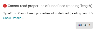

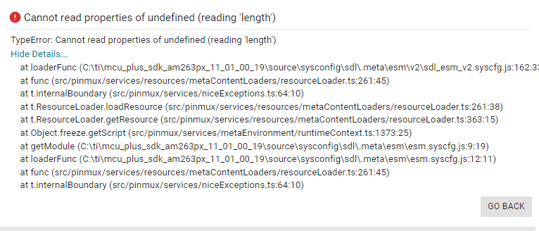

Hello
we are not able to open any SysConfig PRU file for example mcu_plus_sdk_am263px_26_00_00_06\examples\pru_io\empty\firmware\am263px-lp\icss_m0_pru0_fw\example.syscfg in sysconfig even CodeComposer
We try to do it with plenty of version combunation (sysconfig_1.26.2 sysconfig_1.27.0 sysconfig_1.27.1 sysconfig_1.28.) and (mcu_plus_sdk_am263px_10_02_00_15  cu_plus_sdk_am263px_11_00_00_19 mcu_plus_sdk_am263px_11_01_00_19 mcu_plus_sdk_am263px_26_00_00_06) and NONE of this works.
Reproduce:
Use SysConfig (any version) "Open an Existing Design", choose examples\pru_io\empty\firmware\am263px-lp\icss_m0_pru0_fw\example.syscfg (any version of SDK) and it fails
When we try open it on the CodeComposer, it not fail, but it just silently do nothing.
