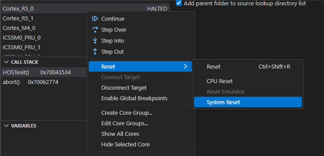

  • Hi Niel,
    It is not possible to do system reset via uniflash, it can only reset the CPU.
    Is there a way to get the XDS110 and/or UniFlash to provide a proper hardware reset using the RESET output ?
    While XDS110, you can do system reset

  • Soft reset its just a core and register reset not mcu reset.
    The only way I can program the board is to try and time a physical reset and click "Load Image"
