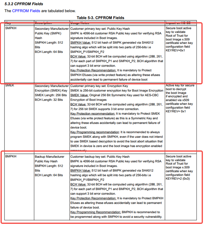

According to the Keywriter introduction in `README_FIRST_AM263PX.html`, the Keywriter injects fields such as MSV, SMPK/SMEK, BMPK/BMEK, EXT OTP, KEY COUNT, SWREV–HSM, SWREV–APP, SWREV-SBL, and KEY REV. I understand that these fields are programmed into the OTP region. However, the table below indicates that for SMPK and BMPK, only their corresponding hashes (SMPKH and BMPKH) are injected, rather than the keys themselves, whereas the other fields are programmed with their raw data values.
My question is: are SMPK and BMPK actually programmed into the OTP region (though not accessible to developers) with the table simply listing the OTP data that we are allowed to read? Or is it true that what gets programmed into the OTP region for SMPK and BMPK is indeed just SMPKH and BMPKH? If the latter is true, how can this serve the purpose of signature verification, given that a hash cannot be reversed to derive the original key data?
    Yes, the OTP would only have hash of the public key. The certificate is signed using private key and then you will have the public key in the certificate which will be validated using the hash in the OTP and then use this public key to authenticate
