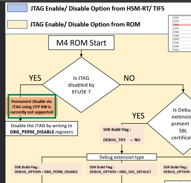

The secure debug for AM263Px SitaraMCU processor information is spread across multiple sections of the technical documentation. The SDK has been helpful in understanding the concept—thank you for that.
However, we have a few follow-up questions:
Permanent Debug Disable: Our requirement is to permanently disable debug access. In the SDK, we noticed the API: SecMgr_isJTAGDisabled()
1. Is checking this status sufficient to confirm that JTAG/debug access is fully and permanently locked?
Alternate Debug Access Paths
2. Are there any other possible interfaces or mechanisms through which debug access could still be enabled, even if JTAG is reported as disabled.
OTP / eFuse-Based Disable
While looking for clarification, we came across a presentation stating (: https://e2e.ti.com/support/microcontrollers/arm-based-microcontrollers-group/arm-based-microcontrollers/f/arm-based-microcontrollers-forum/1531676/mcu-plus-sdk-am263px-method-to-enable-secure-debug-on-r5f-and-hsm-core/5893756?tisearch=e2e-quicksearch&keymatch=Secure%20debug ):“Permanent disable via JTAG using OTP KW is currently not supported.” Could you please clarify:
3. Does this mean that permanent debug disable using OTP/eFuse is not supported?
    The default state of the device is JTAG locked in HS-SE. This API is used to read if JTAG is disabled from EFUSE. If you are opting for this option, then this API reflects the status of the same.
    Yes, the efuse path of permanent jtag disable is not suggested (As mentioned in HSM Addendum).
    Hence we can use the SBL certificate with debug disable extension to get a permanent disable as ROM disables the JTAG in this case, so from a customer POV, the JTAG is always disabled. To enable it back, we need to update the SBL certificate to unlock JTAG.
    Yes, this is not available using OTP KW. The efuse driver is present in TIFS SDK, which you can use to  write to Efuse. But as mentioned earlier, not recommended method of JTAG disable

  • I have one final question regarding debug. I found two diagrams that show eFuses being used for debug control.
    When the debug-control eFuse is blown, does the permanent lock disable only the JTAG debug port, or does it also disable all trace interfaces?
    The ROM disables the trace during this debug disable using the below register.
    I'll confirm internally if this is a sticky register (i.e. can be written only once upon power ON and resets only on a power cycle).
    If this is the case, then trace is also permanently disabled.
