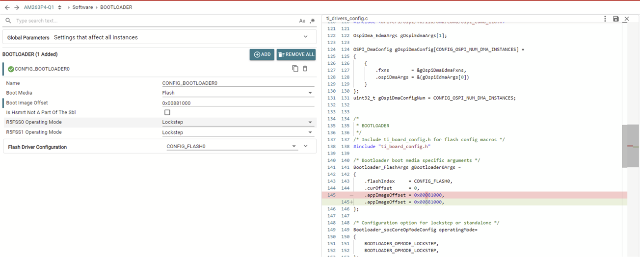

    We are using RAT because we want to switch the source application image when SBL loads the application image from OSPI Flash. Specifically, we would like to load the application from one of the following locations:
    Side A: 0x60081000
    Side B: 0x60881000
    At the moment, in the SysCfg BOOTLOADER configuration, the Boot Image Offset appears to be fixed at “0x60081000”.
    Question:
    Other than using RAT, is there a way to dynamically switch the source address of the application image while SBL is running?
    In order to switch the source dynamically, we tried changing the source address during SBL execution using the following approach before calling Bootloader_parseMultiCoreAppImage, and it appears to work correctly. Is this method recommended and/or supported?
     gBootloader0Args.appImageOffset = 0x00881000;
    Requested response date: July 1, 2026

  • Hi Imaoka-San,
    There is always the option of AB Swap which is recommended for such usecases.
    The ideas of changing gBootloader0Args.appImageOffset should also be fine. This is equivalent to changing the address offset in sysconfig.
    Changing the addressoffset of changed the appImageOffset.
    Thanks & Regards,
    Aswin
