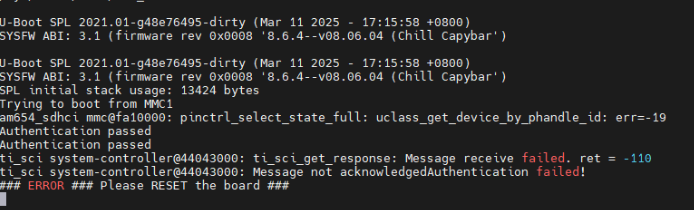

AM625: AM62x uboot failed
Part Number: AM625
Hi
"I'm using a custom AM625 board. When testing the boot time, I occasionally encounter the issue shown in the screenshot. The error only happens sporadically.
  1. What is being checked at this stage? How can I understand what's happening here?
  2. What should be my troubleshooting direction for this error?"
thanks

  • Hi Hao,
    In the screenshot of the console log you provided, the first two lines look identical to the next two lines. Are all the four lines printed in the same power cycle to the board? Or did you power cycled the board after the first two lines printed?
    Do you see the mmc pintctrl_select_state_full message in every time booting the board even when the boot doesn't fail? or is it only printed when ti_sci failure happens?
    By the way, please copy and paste the log, or attach it as a file if the log is too long. Providing the log in screenshoots make referencing very difficult. It would impact our communication.
  • hi bin
    "The attached txt file is the boot log when my board starts up normally. The screenshot shows the log when an anomaly occurs. This anomaly happens approximately once every 100 reboots. I don't know what exactly happens during authentication. Or could you suggest some directions for troubleshooting?"

    U-Boot SPL 2021.01-g48e76495-dirty (Mar 11 2025 - 17:15:58 +0800)
    SYSFW ABI: 3.1 (firmware rev 0x0008 '8.6.4--v08.06.04 (Chill Capybar')
    The message above printed twice when the boot failed. It is probably related to the boot failure later. But I am not sure what would cause the message get printed twice, looks like the SoC gets reset after the first two lines in the log.
  • Hi bin
    Thank you for your reply. Our self-developed hardware platform exhibits this phenomenon during power-on startup. Therefore, I built a device that uses a relay to control the power-off and power-on operations of the device under test.
    This first printout was generated during the previous power-off operation. Due to a momentary fluctuation in the power supply, the SPL restarted once. However, it then waits 20 seconds before powering off and restarting again. As a result, there is a 20-second waiting period between the two outputs, which can be observed when reviewing each log print.
    Regarding the "Authentication" section — what operation is the AM62 performing here? Do you have any documentation on this that you could share so I can better understand the issue? I found from my own investigation that this error occurs due to a timeout during re-communication with the R5 at the boot stage. I'm wondering if my understanding is correct.
    regards
  • After the console prints "Trying to boot from MMC1", the R5 SPL loads the sw components in tispl.bin from eMMC (it appears you board boots from eMMC) to DDR and pass them to SYSFW for authentication.
  • Hi bin
    My understanding is that the communication timeout generated by the hardware channel should be investigated. What should I focus on in my next investigation step?
    regards
  • Hi Hao,
    As mentioned above, I am unable to provide debug guidance for the old SDK v8.6 which is no longer supported.
