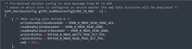

I am working on custom SBL and which shall communicate with HSM ROM Boot to load HSMRt.
While going through the TRM and implementing a mailbox-based communication flow, I am facing some confusion regarding register accessibility and the interpretation of “per-core mailbox registers.”
My understanding as per TRM MBOX communication (Below snapshot).
The description of Step 7 and Step 8 is somewhat confusing.
  • Step 7: R5SS0_CORE0 reads the register R5SS1_CORE1_MBOX_READ_DONE.PROC3 to check for the acknowledgment.
  • Step 8: R5SS0_CORE0 writes 0x1 to R5SS1_CORE1_MBOX_READ_DONE.PROC3 to clear the interrupt.
However, it is unclear how this mechanism applies in the case of R5 ↔ HSM communication, since the R5 core does not have access to registers such as HSM_SOC_CTRL_HSM_MBOX_READ_DONE.
 Please find the Diagram I created for R5 ↔ HSM communication ,
Could you please clarify:
  • Which register should the host (R5) monitor to detect the READ_DONE_ACK from the HSM core?
  • Will it be possible to check the Read Done ACK in Polling mode.

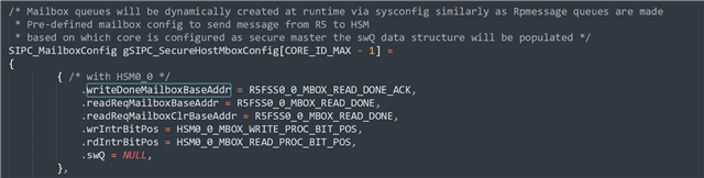

    Checking the flow implemented in the software,
    Here we are doing R5FSS0_0_MBOX_READ_DONE_ACK and R5FSS0_0_MBOX_READ_DONE for R5F and HSM0_0_MBOX_READ_DONE_ACK and HSM0_0_MBOX_READ_DONE for HSM.
