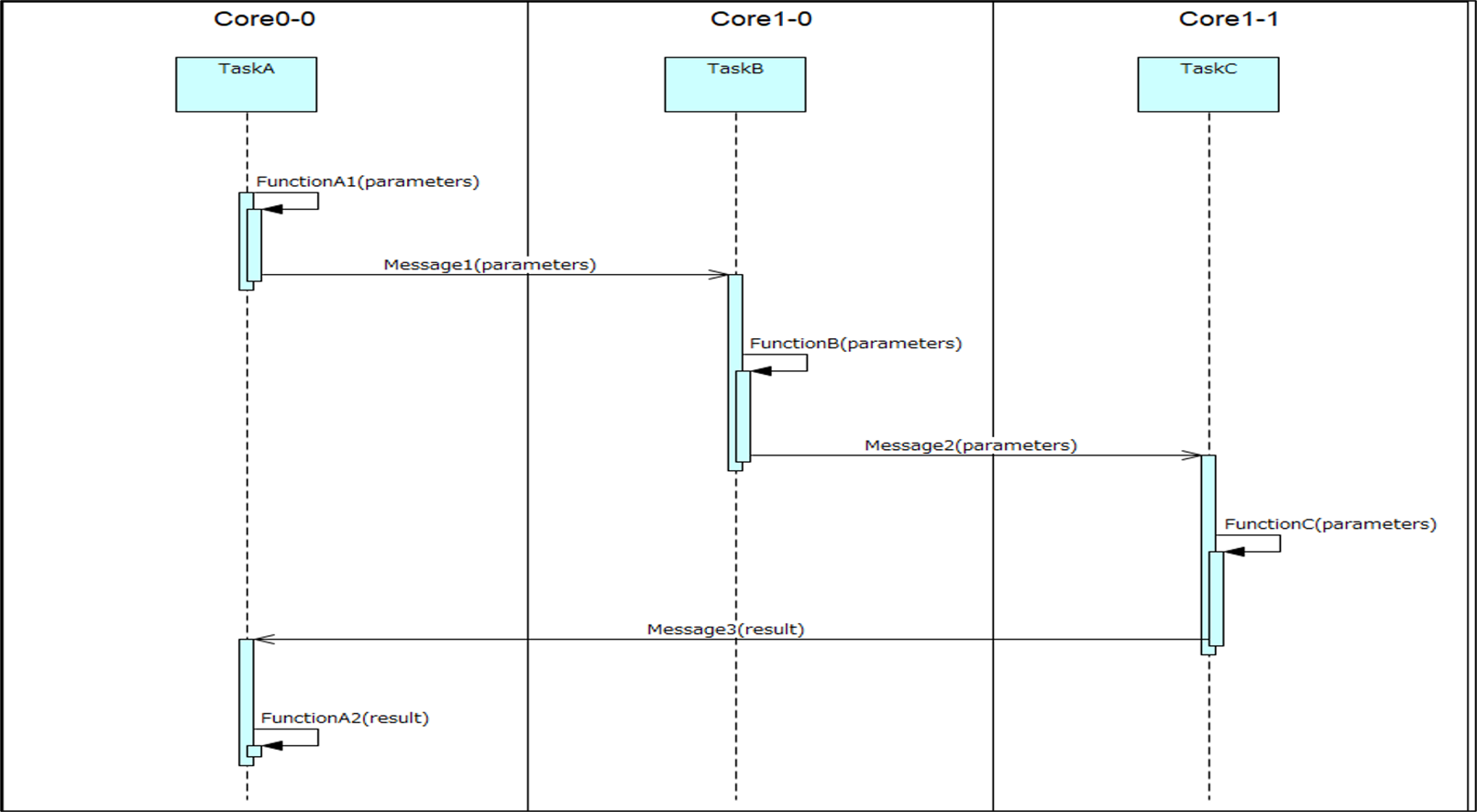

We are considering automating testing using JavaScript (DSS: Debug Server Scripting) in CCS.
Is it feasible to implement the following?
If it is possible to implement the above, could you also provide a sample script and the procedure for
executing it?
Confirm whether a CCS script can be executed for functional verification
 Sample sequence diagram
Could a script like the following be created to verify that the above sequence operates correctly?
Points for Verification
Verify that the functions are executed in the following sequence:
Verify that the parameters passed to each function are valid and correct.

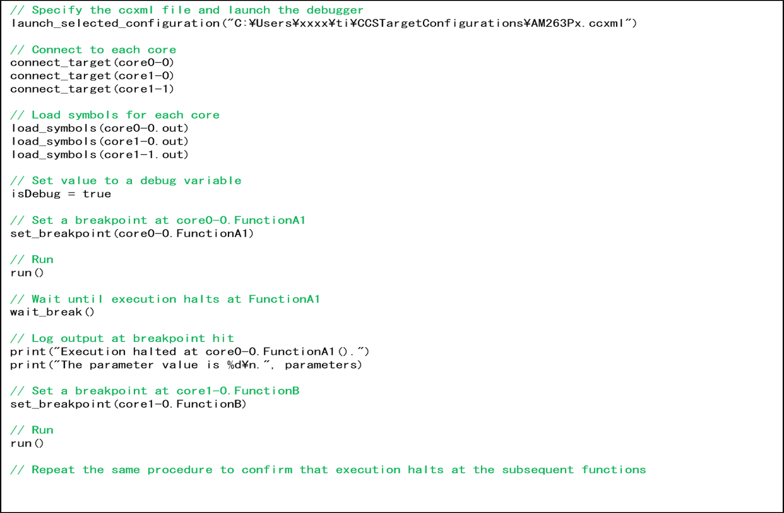

Pseudo Script

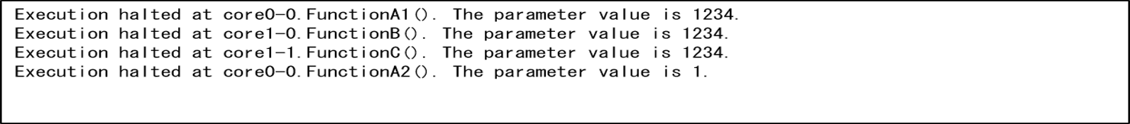

Sample Log Output
If it is possible to create a script as described above, could you kindly provide a sample implementation?
