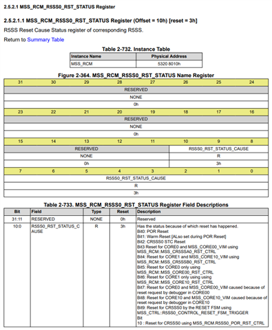

  • Hi Rio,
    A few questions:
    1. Is this SBL being compiled with -O2 or the application? Does the application randomly exit and re-boot and run the SBL? Does it happen after certain "x" seconds/minutes or can randomly occur?
    2. Does everything work fine with -O1 flag, can you also try -Os flag?
    3. We might not get much information from the linker file, we might need to find the exact cause, like if the application is triggering some major assert or abort
    4. Does customer have any watchdog that might trigger a reset?
    5. Can the customer try using this API (or read the memory address attached in screenshot):
    SOC_RcmResetCause SOC_rcmGetResetCause (SOC_Rcmr5fssNum r5fssNum)
    This API/register will give the reset cause, incase the device is getting reset due to some reason, it will tell the cause
    Shaunak

  • Hi Shaunak,
    Our code is built with -O2(or -Oz). When the code executes "tiesc_memset" (inside "bsp_init / bsp_esc_reg_perm_init"), it triggers a HwiP_data_abort_handler.
  • Hi Willie,
    tiesc_memset is not a function used in SDK. We might need some files from your application which use this function. What i believe is happening here is that the compiler is trying to optimize and re-arranging some stuff, causing abort.
