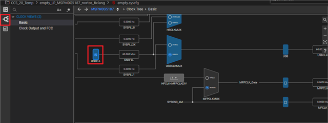

MSPM0G5187: Choosing USBFLL sources as SOF in syscfg has no effect.
Part Number: MSPM0G5187
Hi Experts,
My customer attemps to enalbe USBFLL and chose the reference as SOF in the syscfg, USBCLK (USB clock). However, it has no effect as shown in the "Generated Files" panel on the right.
Is this a bug?
Hang
  • Hi Hang,
    If customer select "Use Clock Tree“ in SYSCTL module of sysconfig, then the clock configuration should be set in clock tree (shown in the second picture).
    If it is not the problem customer meet, could you share their sysconfig screenshot when they meet the issue? Thanks.
