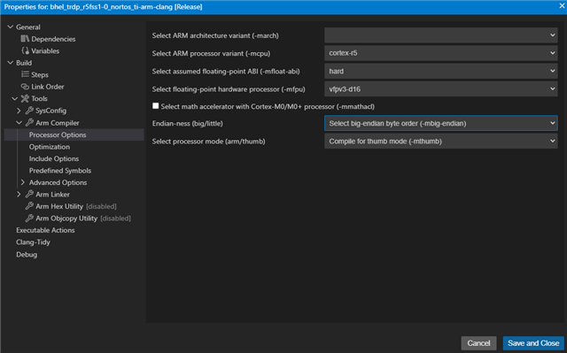

Hi Support Team,
I am trying to build a udp server code with big-endian option enabled in compiler build options.
I get the below error.
[31]fatal error #16001: object files have incompatible byte orderings ("D:/ti/mcu_plus_sdk_am263x_11_00_00_19/source/kernel/nortos/lib/nortos.am263x.r5f.ti-arm-clang.release.lib<AddrTranslateP_null.obj>" = little endian, "./app_cpswconfighandler.o" = big endian)
Do I need to change anywhere else?

  • HI,
    The error shows that your application object files are compiled as big-endian, but the MCU+ SDK prebuilt libraries (like nortos.am263x.r5f.ti-arm-clang.release.lib) are compiled as little-endian. You cannot mix object files with different endianness.
    Solution Options:
    Option 1: Remove Big-Endian from Your Application (Recommended)
    - Remove the big-endian compiler flag from your project build options
    - ARM Cortex-R5F typically runs in little-endian mode, and all TI SDK prebuilt libraries are little-endian
    - Check your project's makefile or CCS project settings and remove any -mbig-endian or similar flags

  • Hi Shaunak,
    I selected the big-endian option in the properties window.
    I am trying this as a worst-case solution. A major problem we are facing right now is that the AM2634 is not able to receive from client's node. AM2634 can send data to the client's node, it shows up on their system. Only their node's data is not received. Their data is being received at all other end-points in the network except for us.
    The crooked issue is that we are able to send test data from our laptop within their network. But ultimately since we have to receive the data from client's node, we have to make this work.
    I am using TRDP protocol for railways application.
    Any idea what could cause the issue? the client uses a CISCO network device.
