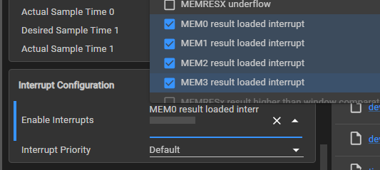

I tried optimizing the power consumption of my device and can get as low as ~4.5uA on my custom hardware in STANDBY1. When requesting a short ADC measurement. however, my current consumption jumps to over 1mA. I did narrow it down to a snippet where I shortly initialise my ADC and start the conversion, then after the conversion stop it again.

This is my problematic code. Inserting a delay_cycles with ~300us or more wait time fixes the issue.

Why exactly could this occur? Why does a delay annul this issue? Why 300us? The time seems quite long to me for a 24MHz device.
When I remove the while loop and the delay, the issue also doesn't occur (no optimization). In that case, however, I assume that the registers have not been processed before turning ADC off again.

    Sorry for the late response. I have checked your code. If you want to let ADC work normally, you need put this code "interrupt_received = true;" into the ADC interrupt case DL_ADC12_IIDX_MEM3_RESULT_LOADED: because if you want to disable ADC, you need for all the memory 0~3 is ready. But in your original code, you put the  "interrupt_received = true;" in the case DL_ADC12_IIDX_MEM0_RESULT_LOADED: and you use
     while (interrupt_received == false) {;} in you code, this will cause that when the memory 0 is ready, you will disable ADC, then cause issue, because you use
    memory 0~3 in your code. But after you add the time delay, it will give enough time to let ADC complete the conversion of memory 1~3, then there will be no issue.

    I want to only do the first ADC conversion. Why can I not stop the conversion with DL_ADC12_disableConversions(ADC12_INST) or DL_ADC12_stopConversion( ADC12_INST) without this issue?

    You can use the DL_ADC12_disableConversions(ADC12_INST) or DL_ADC12_stopConversion( ADC12_INST)  to stop the ADC conversion, this is not the key point of this issue. I have helped you analysis the possible root cause in my last time response. In your application, you used the memory 0~memory 3 to store your conversion result, but you put the flag interrupt_received = true; in the memory0 load interrupt, it will cause "when memory 0 load, the intterupt_recieved will be true, then in your original code (with out time delay) like below figure, CPU will operate adc_off() directly soon which includes the ADC disable conversion. As I said, all of these occurs when memory 0 load, but at the same time, memory 1~memory 3 maybe not ready, that is the reason why you face the ADC usage issue.
    And if you add the time delay in the my_conversion(), it will give time to let memory 1~memory 3 ready, then adc_off() operates, ADC runs correctly.
    That is the reason why I ask you can put the  flag interrupt_received = true in the memory 3 load intterupt.
    Can you understanding now? If you have any questions about my explanation, feel free to let me know.

  • Hello Janz Bai,
    I understand that if I put the interrupt_received = true statement into memory 3 load interrupt, I will not require the delay anymore.
    The problem is that I wish to only do the conversion of memory 1 in this specific case. But if I stop the conversion after memory 0 load, the current consumption stays at 1mA where it should be <10uA.
    What I do not understand is why stopping the conversion and powering down the ADC and VREF does not stop the power flow to the ADC.
