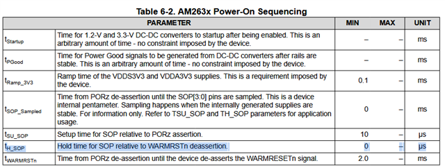

    Could it also be that our RC time constant for driving the SOP lines is not long enough in time?  I noticed that the LP-AM263 Launchpad board uses a 49.9 Ohm resistor and 10nF capacitor for a delay.  However, the note below it says that this creates a PORz RC delay of 1ms which is incorrect.  When we measure it, it was more along the lines of 1us (from AM263 PORZ net on R19 transitioning HIGH to SOP DRIVE OEN R net on U5A pin 4 transitioning HIGH).
    From the PROC111 Rev E2 schematic of the LP-AM263 Launchpad:
    Should we try increasing this GND to +3V RC time delay to 1ms?  The only thing I wouldn't understand though is, if that's the issue, how is the Launchpad working on such a short delay?
    Thank you!
  • Hi John,
    I don't think the RC delay is an issue. As you mentioned the delay value mentioned in the schematics is wrong. The actual delay value is in the order of 1us as you have correctly mentioned. The hold time requirement from datasheet is actually 0µs, so it is not a problem even if we have very less hold time on this SOP lines.

    I think the problem still has something to do with the SOP boot mode pins.  When using the LP-AM263 Launchpad, when we set switch 3 on the SW1 to ON (left position towards the high resistors on the LP-AM263 Launchpad), the boot mode pins are being driven correctly and we are reading 0xB (b1011) in the TOP_RCM_SOP_MODE_VALUE register which corresponds to DevBoot from Table 5-2 in the TRM.  When we try the same switch positions on our custom board, we are getting 0x3 in the TOP_RCM_SOP_MODE_VALUE register which doesn't correspond to any boot mode and is unsupported.  We have tried different RC time constants and even lengthened it to a max delay of about 1.75ms from the time the PORz is de-asserted until the SOP pins are switching from being driven to a Hi-Z output through our SOP tri-state buffer.  When measuring the length of time between the PORz de-assertion to the WARMRSTN de-assertion we are measuring about 3.5ms.  Therefore, we are still driving the SOP pins while in WARMRSTN, and are transitioning to Hi-Z output before WARMRSTN so that there is no bus contention with the QSPI bus.
