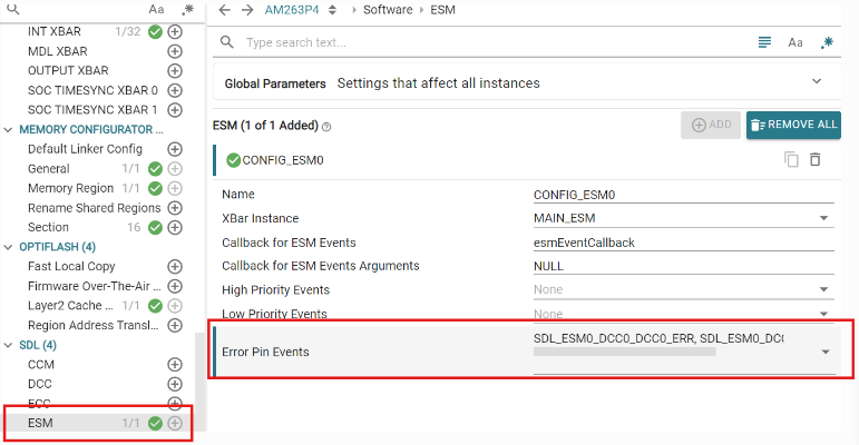

I configured CONFIG_ESM0 in SysConfig and enabled SDL-related Error Pin Events as shown below.
After that, I added a call to Sdl_config() during system initialization.
However, the firmware fails to boot after calling Sdl_config().
Our goal is to detect potential power instability or clock-related issues that could be caused by abnormal supply voltage conditions. For this purpose, we enabled the following ESM error events in SysConfig:
  • SDL_ESM0_CORE_PLL_PLL_CORE_LOCKLOSS
  • SDL_ESM0_DCC0_DCC0_ERR
  • SDL_ESM0_DCC1_DCC1_ERR
  • SDL_ESM0_PERI_PLL_PLL_PER_LOCKLOSS
  • SDL_ESM0_RCOSC_RCREF_CLK_LOSS_DETECT
  • SDL_ESM0_VMON_VOLTAGE_MONITOR_ERR_L
  • SDL_ESM0_VOLTAGE_MONITOR_ERR_H
  • SDL_ESM0_XTAL_CRYSTAL_CLOCKLOSS

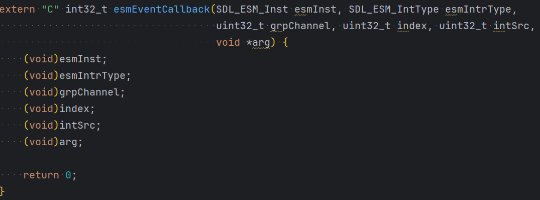

Callback:

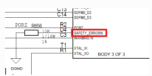

SAFETY_ERRON pin:
  • this is connected to DGND. We are just probing this pin with an oscilloscope.
