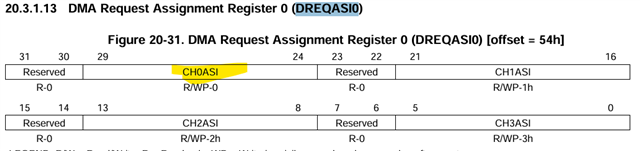

    1. I assign the DMA request as you indicated except I'm using a different channel:
    dmaReqAssign(DMA_CH4, 47);
    The DREQASI1 register has 2F in bits 24-29 as expected.

    You are correct. The data sheet has warning that "only one of these DMA request sources is enabled at any time" means you cannot safely have both the MibADC2 G1 hardware event and the DCAN1 IF3 hardware event driving the internal logic simultaneously.
    Is it possible to remap only the DCAN1 IF3 request to a different channel from MibADC2 G1?
    Unfortunately, you cannot shift a peripheral's hardwired DMA Request Line number. DCAN1 IF3 is permanently tied to DMAREQ[16] at the silicon layer.
    Because both DCAN1 IF3 and MibADC2 G1 share DMAREQ[16], if MibADC2 G1 fires, it will trigger whatever DMA Channel is assigned to Line 16. To make your DCAN1 IF3 DMA work, you must ensure that MibADC2 G1 DMA generation is completely disabled in your ADC configuration. Moving your ADC operations to MibADC2 G2 or Event Group completely avoids the hardware DMA conflict with DCAN1 IF3.
  • It appears that DMA is copying the data to the arrays now, but only when I enabled only one channel at a time in the HWCHENAR register (i.e., I needed to only enable DMA_CH4 for DMA to read the DCAN4 data, with DMA_CH0/1/2/3 all disabled). Is that the way the DMA is intended to work?
  • Hi Cameron,
    No, that is not how the TMS570 DMA is intended to work. The DMA controller is fully designed to have multiple channels enabled simultaneously in the HWCHENAR (Hardware Channel Enable Set) register, allowing it to arbitrate and service multiple hardware triggers (like different DCAN modules or channels) concurrently based on priority.
    If enabling DMA_CH0 through DMA_CH3 completely blocks DMA_CH4 from executing, it typically indicates that one of the lower-numbered channels is continuously triggering or stuck in an active request state.
    The TMS570 DMA uses a fixed priority scheme by default, where Channel 0 has the highest priority and Channel 31 has the lowest. If DMA_CH1, DMA_CH2, or DMA_CH3 are enabled in HWCHENAR, and any of them receive a constant or un-cleared hardware request signal, the DMA hardware will repeatedly service that higher-priority channel. Because DMA_CH4 is lower priority, it will be completely starved of DMA bus cycles and will never execute its transfer.
    Please check the DREQSTAT (DMA Request Status Register). This register shows you exactly which hardware request lines are currently active.
  • Thanks QJ, I don't see the DREQSTAT register anywhere, but in the end my issues appear to have been solved by setting AUTOINIT ON in the channel configuration for DMA_CH4.
