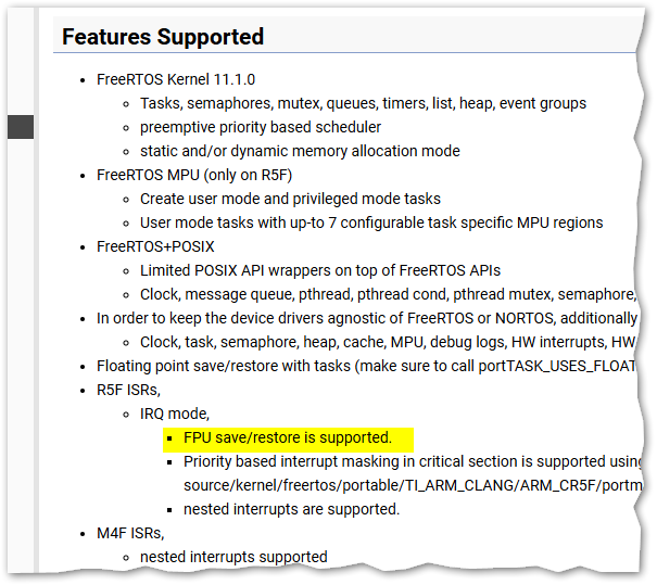

We're getting some strange floating point comparison behaviour in a static FreeRTOS task when it is interrupted by an ISR. The ISR itself also uses FPU.
I note in the SDK docs AM263Px MCU+ SDK: FreeRTOS the words "FPU save/restore is supported":
That stops short of saying it's enabled.
  1. Should I assume FPU context save/restore is always enabled?
  2. If not, what should I check to satisfy myself that it is enabled or that we haven't unintentionally disabled it?
Thank you.

  • That's excellent, thank you very much. Yes, we missed out the opt-in step 4 in our non-MPU OS.
    We think the corruption is solved.
  • One last question  , is there a manual we should have consulted which might have provided this information please?

  • I eventually found a hint that we should have considered this:
    AM263Px MCU+ SDK: FreeRTOS usage guidelines
