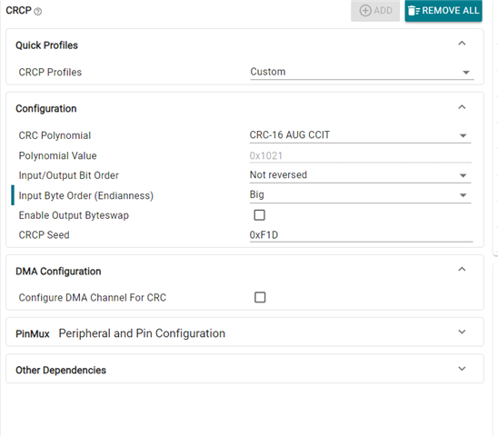

  • Hi Jasper,
    Thanks for the quick reply.
    I am using the Driver Lib genrated by sysconfig for the CRC operation.
    The snapshot of the Sysconfig is below:
    I have looked at the impementation but I could not find the problem.
    Is there a crc16 example I could use?

  • Hi Jasper,
    Thanks.  I tried the proposal but the CRC result still did correspond to the linker generated CRC result.
    The implementation is below
    Linker command file:
    GROUP
      FLASH_APP               : origin = _APP_START_ADDRESS_, length = 0x00070000 - _APP_START_ADDRESS_ - 0x80
    }crc(_flash_crc_table, algorithm=CRC16_802_15_4)
    Calculation in code:
        uint16_t crc_result = DL_CRCP_calculateMemoryRange16(CRCP0, CRC_SEED, (uint16_t *)p_crc_table->recs[0].addr,
        (uint16_t *)(p_crc_table->recs[0].addr + p_crc_table->recs[0].size));
    The generated configuration code is below:
    DL_CRCP_setPolynomial(CRCP0, DL_CRCP_CRCPOLY_POLYNOMIAL_16_AUG_CCIT);
        DL_CRCP_init(CRCP0, DL_CRCP_POLYNOMIAL_SIZE_16, DL_CRCP_BIT_NOT_REVERSED,
            DL_CRCP_INPUT_ENDIANESS_BIG_ENDIAN, DL_CRCP_OUTPUT_BYTESWAP_DISABLED);
        DL_CRCP_setSeed16(CRCP0, CRCP_SEED);
    where the CRCP_SEED is  0xF1D
    The configuration using sysconfig is below:
    Where could the problem be.
  • Hi Abayomi,
    Thank you for providing the CRC algorithm information from your Flash - this is very helpful.
    The configuration I shared earlier was based on the SDK example (CRC-16/AUG-CCITT), which was used to verify that the CRC-P peripheral works correctly on the G3519. Since your Flash uses the CRC-16/802.15.4 algorithm, the mismatch is caused by a difference in parameters between the two configurations.
    To match CRC-16/802.15.4, please update the following settings:
    Change Seed to 0x0000
    Change BitOrder to Reversed
    All other parameters can remain unchanged. Please re-verify the result after making these adjustments.
    Thanks.

  • Hello Jasper,
    I am enclosing two snapshots for you
    1. sysconfig
    2. The CRC parameters form the linker command file used in the calculation
    From the second picture, you can the the start address and the size of the flash memory that is been computed.
    I expect your feedback.
