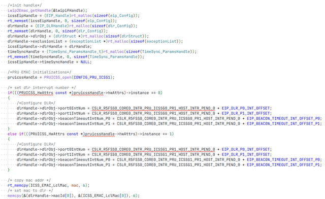

  • In addition, we tried this topology discovery and it worked without any issues.
    The above is our driver code, and the rest of the content is provided in the SDK. Please help check if there are any issues.

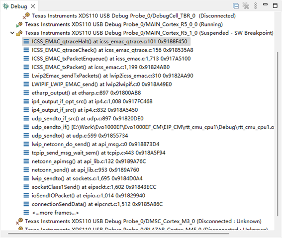

    Moving on to the qtrace log test:
    I set a breakpoint at the while(1) loop. The original problem reproduced, but the breakpoint never hit. I retried multiple times and waited for a long period, still no breakpoint trigger.
    However, once I enabled the Supervisor on this debugged Ring‑Node device, the breakpoint triggered immediately.
    The fault occurs inside function EIP_DLR_serviceRingSupConfigSetRequest. Please refer to the attached screenshot for the detailed backtrace, and the screenshot for variable values.
  • Hi Wang
    Thanks for the logs - we can clearly see the error being Write pointer is out of range.
    From this observation, could we infer that the root cause originates when AM2432 acts as the DLR Supervisor, and this condition in turn triggers faults on the Ring‑Node‑side AM2432?
    That is the likely reason - possibly some configuration that's performing an overlapping write into the ICSS Memory corrupting this value. If you see the log here - the prevPtrVal is 356 (0x164) which is incorrect.
    In order to track the pointer writes of the previous packet rx/tx - can you share the values of the gIcssEmacQTraceLog structure?

    Hi Archit
    I have performed the test. The values at 0x30083E9E and 0x30083EBE were not modified to values below 0x400. However, I observed a mismatch between 0x30083E9C and 0x30083E9E, while these two values are normally identical. At this moment, Wireshark capture showed communication interruption, which indicates the issue has been reproduced.
    I checked the address range you provided. Only 0x30092FEC was non‑zero, consistently showing 0x00040101 across multiple test runs. The memory dump file is attached.
    Wang

  • 3583.WRPTR.dat
    Hi Archit
    The issue still occurs with identical symptoms as before. The memory dump has been attached.
    Wang
