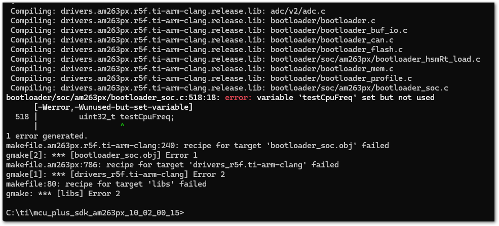

AM263P4-Q1: Libraries Don't Build When DebugP_ASSERT_ENABLED is 0
Part Number: AM263P4-Q1
In SDK 10.2.0.15, as per the related question, I changed the macro to:
#define DebugP_ASSERT_ENABLED 0
Then attempted to rebuild the libraries. The make stops a number of times in a few libraries due the following types of error.
I added the following to the problem makefiles.
    -Wno-unused-but-set-variable \
    -Wno-unused-variable \
Please check and update the makefiles if that is the right course of action.
