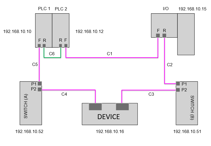

The configuration we are using for testing is a ring network with:
- a redundant S7-1500 PLC (192.168.10.10 and 192.168.10.12)
- two Scalance switches (192.168.10.51 and 192.168.10.52)
- an ET200SP (192.168.10.15)
- one of our devices (192.168.10.16)

I've attached the Wireshark traces of the two Scalance switches filtering only traffic between PLC and our module when it works and when it doesn’t (there is a time difference of a few seconds between the two traces) and the serial logs from the devices. What seems to be happening is that after the reboot, the write module (PLC -> device) never recover to status Good.
What could be causing this? What can we do to investigate this issue further?
