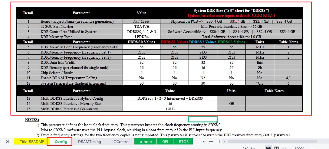

TDA4VH-Q1: ddr parameter confirm
Part Number: TDA4VH-Q1
ddr_par.zip soc-LP4-sch.pdf
During the power-on and power-off of the pressure test, we found a problem of the U-Boot getting stuck. We suspect it might be related to the DDR. We would like to ask you to help check if there are any issues with the parameters and connections related to the ddr
the parameter was generated using the excel tool SPRACU8B_jacinto7_DDRS_RegConfigTool,version number is 23rd,2023,0.10.0
