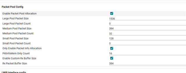

    3. We might be running out of Rx packet descriptors, this is set by sysconfig, can you share both example.syscfg files (launchpad and custom board) so i can compare them.
    4. Can you try increasing the number of Tx and Rx packets in the sysconfig. Reference documentation: https://software-dl.ti.com/mcu-plus-sdk/esd/AM261X/latest/exports/docs/api_guide_am261x/PACKETPOOL_CONFIG_TOP.html
    Basically increase the number of packets i have highlighted below. The Tx and Rx packet count should add up in the Packet pool config. If we are running out of packet pools, this should fix it.

    Q3: See attached files: example1.syscfg is for the custom board, and example2.syscfg is for the launchpad.
    Q4: The customer modified the configuration as instructed/suggested, which resulted in abnormal communication. The image show below. Is there anything in it that should be improved?

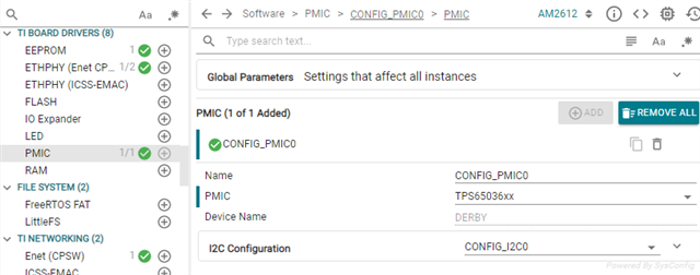

  • Hello Ethan,
    as discussed in the call, please try the pmic related fix for WDT we discussed. Follow these steps to do so:
    1. Add the PMIC module to syscfg :
    2. In CCS, add the following library path and the library:
    path : <mcu_plus_sdk_path>/source/board/pmic/lib
    library: lpmic_derby.am261x.r5f.ti-arm-clang.ti-arm-clang.freertos.${ConfigName}.lib
    3. rebuild the application and see if the error occurs again.
    let us know how this goes.
    Aravind
  • Hi:
        1.I have tried the pmic related fix for WDT ,and then the problem has been resolved . Thank you for your help.
        2.I want to know more about it .Are we adding PMIC to enable watchdog or disable watchdog.

  • Hi d XB,
    Glad to know the issue has been resolved.
    If the PMIC part is same as the AM261x, the we are adding PMIC in syscfg to disable the pmic watchdog. Certain PMIC parts have their own integrated watchdog for safety. It either needs to be serviced or disabled.
    https://software-dl.ti.com/mcu-plus-sdk/esd/AM261X/latest/exports/docs/api_guide_am261x/RELEASE_NOTES_10_02_00_PAGE.html
