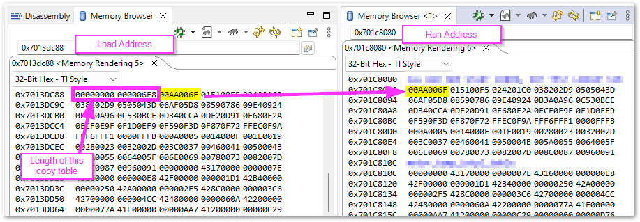

I need to extract the initializers for .data variables which are used for such things as conversion from ADC value to physical value (i.e. the m and c in y = mx +c) into a hex file. The hex file is then imported into Vector CANape and modified as part of calibration activity.
The initializers are of course the contents of a copy table. I have already switched off copy table compression to make this feasible.
In my application, the copy table in question starts at CAL_DATA_SECTION load address + 8. The offset of 8 bytes is because the first 8 seem to be a copy length specifier which I don't need.
.cinit     0    70137268    000078d8
                  70137268    00006a20     (.cinit..data.load) [load image]
                  7013dc88    000006f0     (.cinit.CAL_DATA_SECTION.load) [load image]
In this build, I want to extract, address 0x7013DC90 (= load address 0x7013DC88 +8)

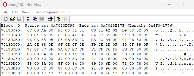

However, after some trial and error, with the following script:
"./core_0/core_0.out"
--intel
--image
--exclude .text*
--exclude .vectors
--exclude .rodata
ROMS
    cal_data_section : origin=0x7013dc90, length=0x6F0, memwidth=8
I managed to get a file called core_0.i0 containing the expected data:

    LINKER GENERATED COPY TABLES
    __TI_cinit_table @ 7013ea7c records: 24, size/record: 8, table size: 192
    	.data: load addr=70137268, load size=00006a20 bytes, run addr=7012dbe0, run size=00006a18 bytes, compression=copy
    	CAL_DATA_SECTION: load addr=7013dc88, load size=000006f0 bytes, run addr=701c8080, run size=000006e8 bytes, compression=copy

    I opened the .out file with ASAP2 Demo and I can see now that CAL_DATA_SECTION only appears as a run address section. All of the copy tables including the copy table for CAL_DATA_SECTION must be wrapped up in the .cinit section and cannot be further decomposed by the tiarmhex utility.
