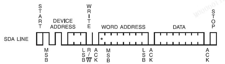

My cusotmer is try to implement UC3 I2C in the basic I2C module of AM13
There is no repeated start in the tree bytes.
But the basic I2C seems to be limited to one byte per transfer, and we can not avoid the stop after one byte.
How to do this in the basic I2C module?

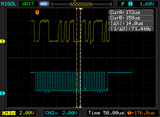

  • Hi Dalaney,
    Sorry for the delay.
    I tried the above sequence, however the stop are still there
    I am not sure if I am following the sequence correctly. Could you please help providing an demo?
    Just generate the blow sequence:
    Hang
  • This appears to show the SLA (slave address) byte encountering a NACK; in that case the master will Stop immediately.
    Are you fairly certain about your target device's address? It looks like you're using 0x3C.
  • Hi Hang,
    Bruce is correct, that scopeshot shows a NACK to the address byte. Can you verify that the target address is correct?
    Delaney

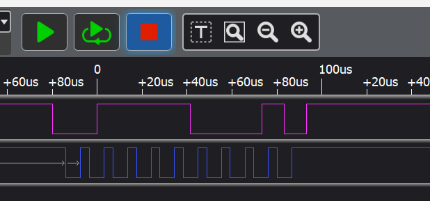

  • Hi Delenay & Bruce,
    I used an external loopback to handle the ACK. After adding it, the above code yields an unexpected waveform, where Sr and P is inserted in the middle of the transfer. Although the loopback is receiving the correct data, I think this result is not enough.
    I attached example I test. The example is modified on top of the loopback exmaple and it;s largly simplified (BTW, I don't understand why the original extern  loopback are so big when the purpose is only to demo a simple loopback. It took a long time to get rid of the part that's not necessary. I believe it's better to keep examples as simple as possible, it would help espcially for ones who is add more codes on top of it. Please help conveying this message to SDK team if possible..)
    i2c_uc3_test.zip
    The external connection of this example is identical to the original example, you may take the connection in the original readme.
    Hang
  • I don't see this symptom on the MSPM33. I think I mostly duplicated your experiment, though my device only has one Basic-mode Unicomm (UC13) so I gave it to the Controller side.
    The (false) Sr occurs during the ACK cycle; I don't know how software (alone) can do this. My first thought was something about clock-stretching, though I see that's enabled on both ends.
    The Target didn't seem to notice the stray Sr/P sequence, since it went ahead and ACK-ed the next byte. I'm wondering if your Analyzer has a different view of Vih than the Target. Are you relying (only) on the internal pullups? If you have one, a scope could disambiguate a slow-rise condition. Alternatively, try slowing the bus down.
  • Hi Burce,
    Upon examating the waveform in the osciliscope, I found that the Sr and P are actually some the simutainous flip of SCl and SDA, occured at the last clock of the second byte. This should be the behavious of the ACK, but recognized as Sr P due to some propagation delay or threshold issues.
    I would consdier the basic I2C is achieved and would share with customer to text, thanks for the support!
    Meanwhile, may I know what's introducing the SCL gap between the sccond and the third byte?
    Hang
  • The gap is almost certainly software. Though the TRM doesn't say explicitly, I expect TXDONE is issued only after the ACK (the I2C is thus momentarily idle), so there's a delay while the software is scrambling to load the next byte FRM_START.
    In Burst (Advanced) mode the TXDONE only happens after the last byte in the burst; since this is typically combined with the Stop you don't see the gap. I suppose you would see this in Burst mode when using Repeated Start, though I use Read On TXEmpty, so there's no software involved in the Repeated Start.
    [Edit: Minor clarification]
