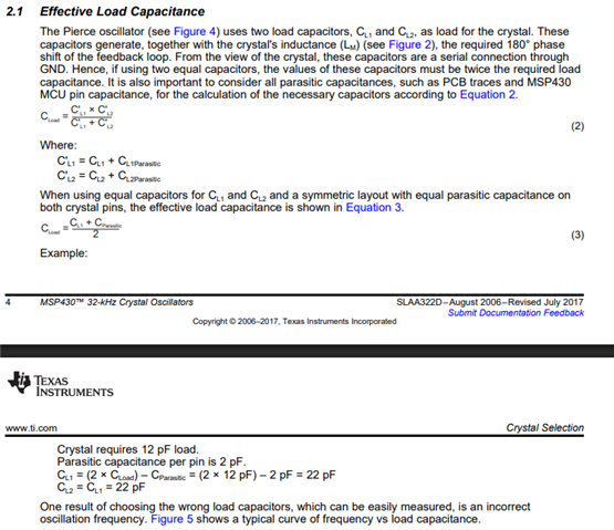

    The customer can find some references in the following document regarding the capacitor recommendation for load capacitance (the document still applies for MSPM0 devices, and crystal higher than 32KHz)

    The MSPM0 does not have a specific preference; the choice between a ceramic or crystal resonator is up to your team's evaluation for your system. My team can provide a general recommendation if we receive more details regarding the application.
    Additionally, the load capacitance is not a specification that the MSPM0 requires to operate correctly. However, attaching the correct capacitors to the crystal is important to ensure that the accuracy of the crystal or ceramic resonator is maintained.
     mentioned below; I have included a summary of the process here for your convenience:
    The method for calculating load capacitance is described in the document document  mentioned before,; I have included a summary of the process here for convenience:
