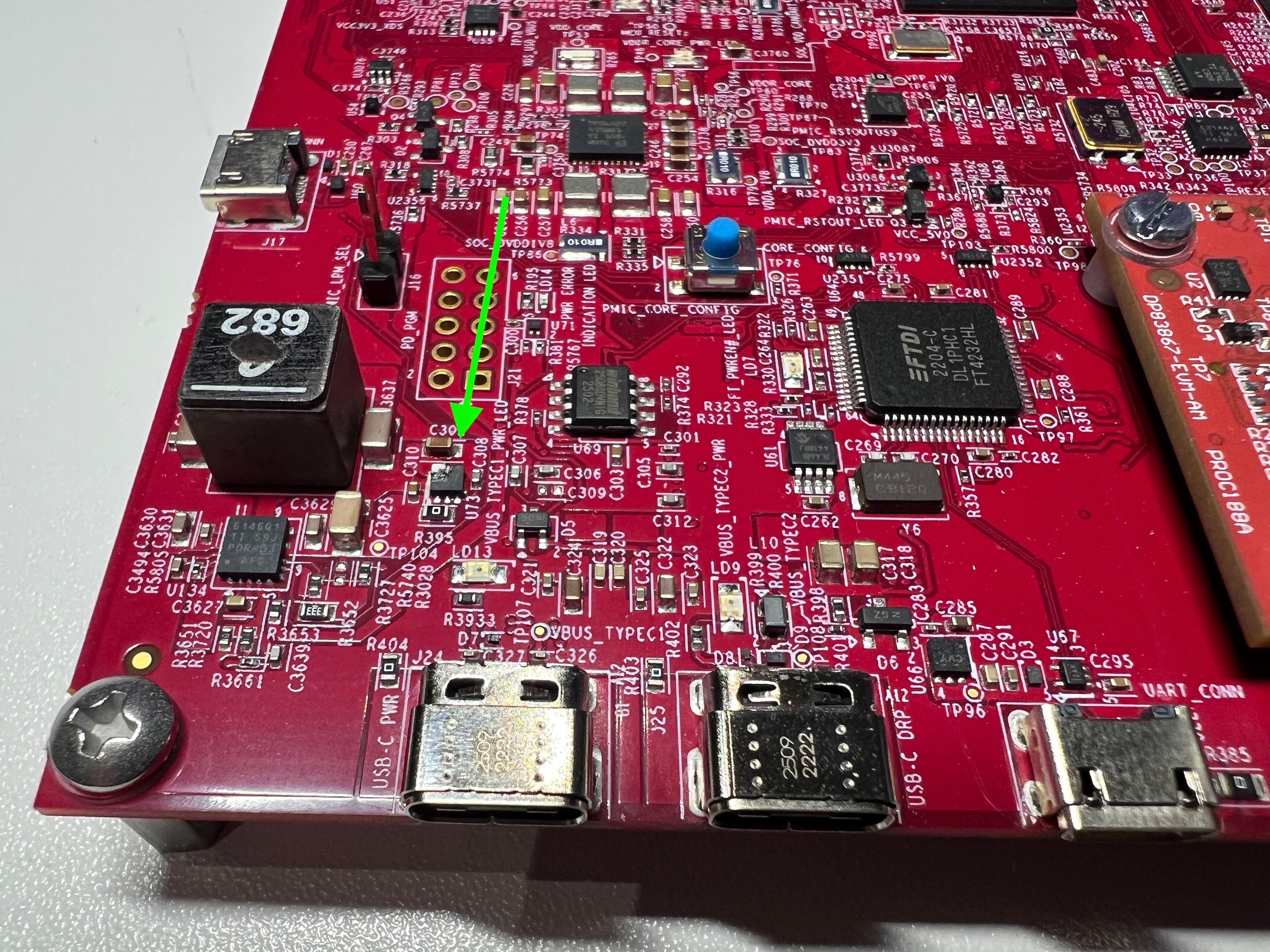

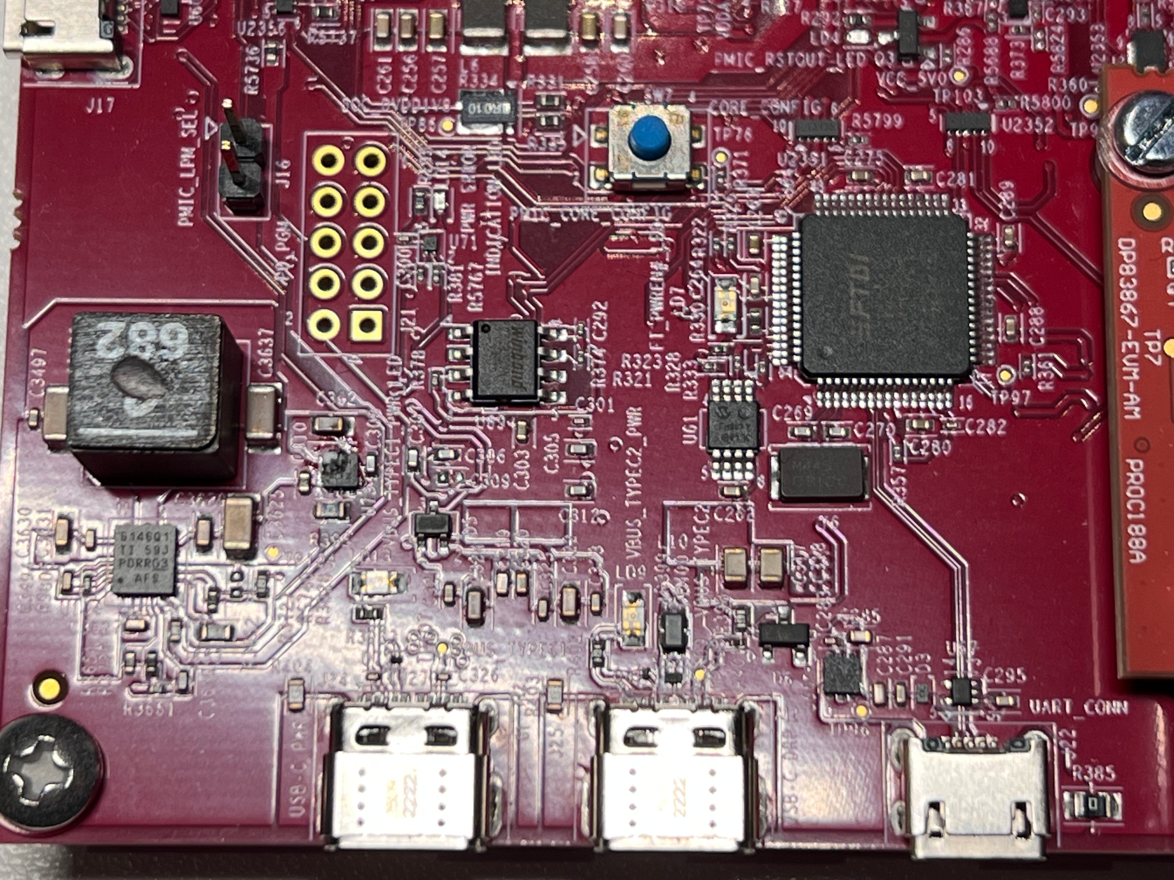

My AUDIO-AM275-EVM lately got broken and i created a case. Within the communication of that case, i was asked to post the failure hiere in the forum, so i do:
Thanks fpr your assistance!
BR
Matthias
  • Serial Number: 23261900238
  • Failure Description: Power fault LEDs flashing upon power-up, followed by thermal runaway at component U73 (smoke emitted)
  • Power Source Used: USB-C PIMG_0267.jpegIMG_0266.jpegower Delivery wall adapter via Type-C PWR port

  • Hi Mattias,
    Unfortunately, this board is not eligible for replacement since it was functional when originally received.
    The U73 device is a power switch used to toggle between the two USB-C power ports. In the case of U73 experiencing an overcurrent event, (maybe due to a short downstream in another part of the EVM) it could have become damaged. The large inductor to the left of U73 in your photos is the VCC_5V0 rail inductor. This inductor is an 11A DC rated component, but appears damaged in your photos. This also indicates an overcurrent event was seen.
    Can I ask how exactly you were powering this board? What supply was attached to the USB-C power input? A standard USB-C PD supply should have disconnected in the case of an overcurrent event.
    Thank you,
    -Randy
  • Hi Randy,
    The board was powered using momax UA10 adapter using PD USB-C output C2 capable of delivering up to 35W. Adapter has been used with various devices across many years without issues or damage to any other device.
    Can you confirm that the power-delivery negotiation is properly implemented on the TI-PD controller?
    The large inductor L24 is not damaged as it looks exactly like inductor on the other board which is running fine. Both "out-of-the-box" have some manufacturing residue glue/paste-like piece that can be simply removed.
    The AM275x was the only device connected. It seems as if it failed PD negotiation with the adapter. Indeed PD should have negotiated a safe 5V baseline before allocating power. The user guide states the board requires a source capable of more than 15W, with no warning that a higher-wattage USB-PD supply is incompatible or dangerous.
