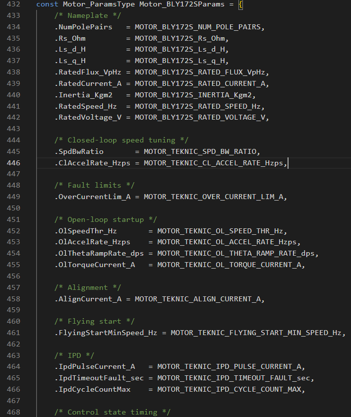

I'm currently running the 3-Shunt Hall Sensored FOC motor solution from the AM13E23X SDK with a DRV8323RS driver and BLY172S-24V-4000 motor. Here are the edits I have made to the code to run the motor:
  1. Motor_params.h
    1. Added the macro block for BLY172S nameplate parameters
    2.  Updated the MOTOR_PH_Ls_d_H and MOTOR_PH_Ls_q_H aliases
  2. Motor_params.c
    1. Added const Motor_ParamsType for the BLY172S with the nameplate parameters and copied over the MOTOR_TEKNIC values for all other parameters.
    2.  Updated motorParams_M1 pointer to point to the new const
When I initially startup the debugger through CCS, I always enter the default_handler for unexpected interrupts before motorVars_M1 is set to the parameters I have set. It is not until I restart the debugger where these variables are populated with values. I have gotten the motor to spin with the same code setup, but it will not spin in every iteration. When the motor doesn't spin and I pass the default_handler, it will never exit calibration (in main.c) for some reason.
I have not changed files outside the ones I have listed. I was planning to use TiTune or instaspin to get more accurate parameter identification but I have not been able to get the motor to spin with this. I'm on sdk 26.01.00.03 but is there anything I'm missing in my set up that is triggering the interrupt or keeping me in an indefinite state?
