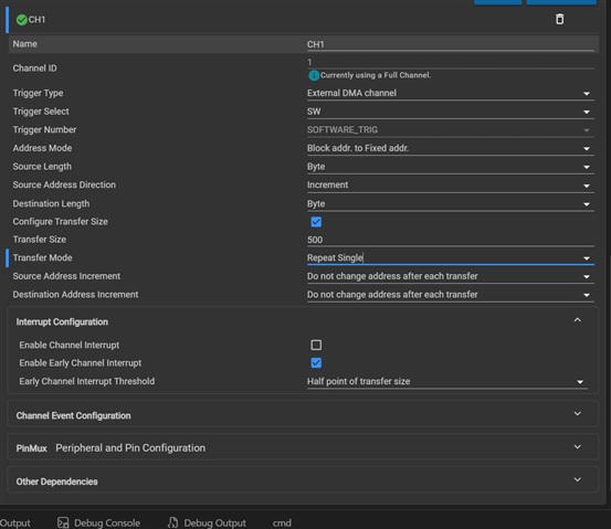

  • For a serial (SPI) port I would expect to see Transfer Mode "[Repeat] Single" and Address Mode "Block address to fixed address" (for Tx)..
    The first allows the SPI unit to meter the data, and the second puts each byte into TXDATA.
    This configuration will DMA the entire packet on each trigger, spread over the register space.
  • Thanks everyone, I am now getting full frames with the correct timimg.
    However, I am not getting the PREIRQ interrupt. I thought I was because the DoTop variable was getting set. But then I saw the bug in my interrupt routine above. I was missing the break after the case, so I was falling through the second case statement! When I put the break in and moved the PC12 GPIO pulse to the PREIRQ case, I don't get the pulse. My Sysconfig for the PreIRQ interrupt is as above and I actually re-enable the interrupt in my init code. What am I missing?
  • Notwithstanding the verbiage in the TRM , it appears that the PREIRQ path (back) to the Unicomm isn't implemented (yet?). CMSIS defines a bit for this (IMASK bit 19) but attempts to set it are ignored and the corresponding RIS bit is never set.
    The PREIRQ event can be caught as a DMA0 interrupt. The ISR might resemble:

    1) You're enabling the (SPI) TX_EMPTY interrupt, but I expect you don't want to do this. This condition will occur fairly frequently, but the DMA takes care of it (you shouldn't get in the way).
    2) The DMA channel initialization generated by Sysconfig sets the PREIRQ threshold, but then DL_DMA_initChannel() sets it back to =0 (disabled) by omission. I suppose they'll fix this bug someday, but for now you should add this after the call to SYSCFG_DL_init:
        DL_DMA_Full_Ch_setEarlyInterruptThreshold(DMA0, DMA0_CH0_CHAN_ID, DL_DMA_EARLY_INTERRUPT_THRESHOLD_HALF);

  • Do I set up the sysconfig DMA interrupt settings pretty much like the SPI DMA settings? (I guess I should remove the pre-irq stuff in the SPI)
  • Observed behavior: When you request the SPI->DMA Channel Event->Interrupt Configuration for Enable Early Channel Interrupt, it enables PREIRQ in the DMA channel (not the SPI).
  • Thanks! That is probably why I did not get a conflict error from SysConfig.
  • Thanks Bruce! Both interrupts are firing now. Monday I am going to see if I am dropping any frames...
    I did add a
    DL_DMA_enableInterrupt(DMA0, DL_DMA_FULL_CH_INTERRUPT_EARLY_CHANNEL0);
    To enable the specific interrupt.
    I am marking this solved
