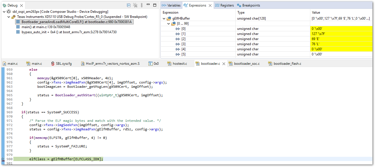

I have a working SBL using Infineon S25FL128LAGNFI010 - Quad SPI flash | Infineon Technologies running 1S-1S-4S protocol.

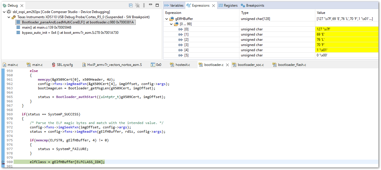

When I change the protocol to 4S-4S-4S, the function Bootloader_parseAndLoadMultiCoreELF() fails because the ELF header bytes read from flash are shifted by one byte in the buffer:
1S-1S-4S (Working):
4S-4S-4S (NG):

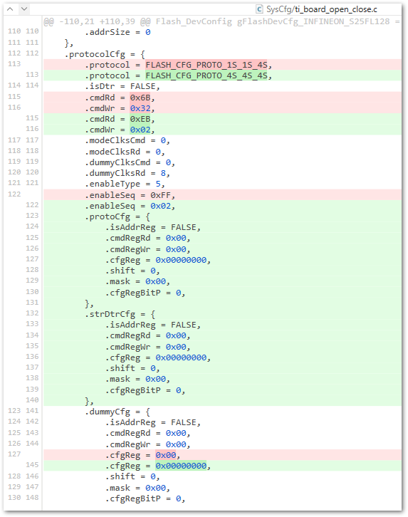

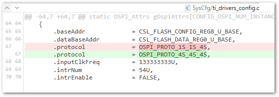

Here are the generated changes:
Flash reading must work in principle otherwise I would get garbage but it's just the placement of the 0x7F E L F in the buffer which is problematic.
Can you point me to a potential cause please?
