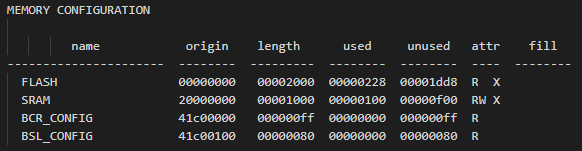

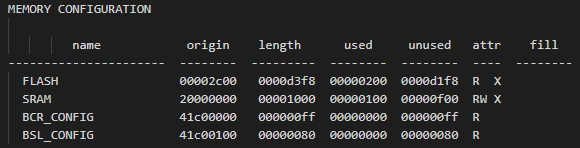

I have verified that both *.out files do not overlap each other by reviewing the map files:
I'm assuming I'm missing some configuration step that is required for the multiLoadStart/multiLoadEnd construct, but I'm not sure.  Does anybody have any insight into why the multiLoadStart/multiLoadEnd construct isn't working, or have an example that does work?
